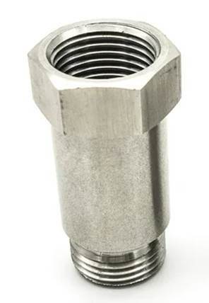

Your O2 sensor has an extender on it like the one pictured below. Those move the sensor out of the exhaust flow so it reacts slower. They are used on the after catalytic O2 sensors to fool the ECU as a shortcut to get rid of the "low catalyst efficiency" codes and not have to replace the cat. I have no idea why anyone would put those on the pre-cat O2 sensors but if they did you would immediately get that P0133 slow sensor response code that you have. I would take the spacers off and try your existing O2 sensors. I'll bet you get rid of your P0133 code and get some other code that is the root of the problem someone tried to fix by mis-applying those spacers.
