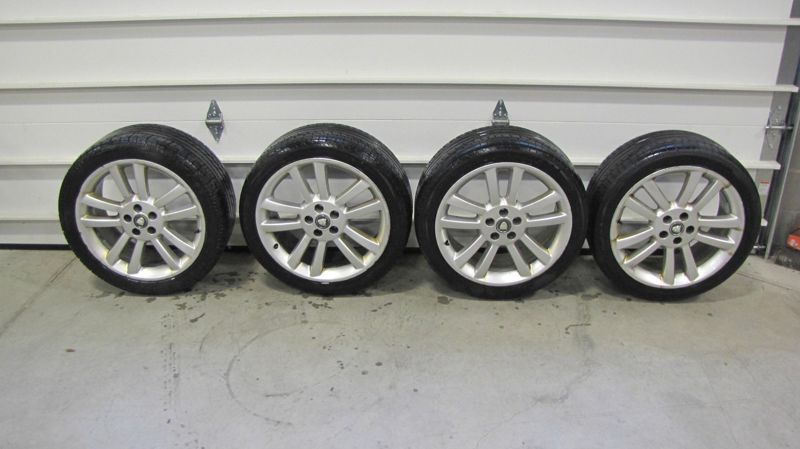

Sorry to bring a old thread up, but how would these XF wheels looks on a silver X Type?
Also are they even XF wheels?
Attached Thumbnails 2009 XF wheels on 02 x type??-t2ec16fyse9sy0ggdjbrgwcqbodg60.jpg

Those look like XK wheels. I think they are 8s in front and 9s in back. I'd put 235/35/19s on them all and they should be fine without any spacers or fender rolling. Do you have lowering springs or is your car stock height?

The car is stock height.
