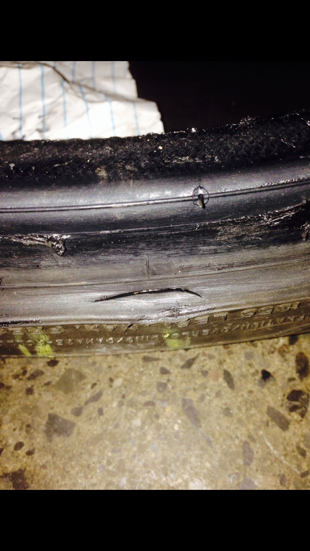

I just had a friend stop by who saw my tires, he asked why dont i just put an inner tube in and still use the one with the cut?.
Is this a viable and safe remedy?

iownme, based on the pic, it looks like the cords are damaged and even with that, I could not recommend putting in a tube and running it that way. While it may hold air that way, you risk having the tire come apart as you are at speed and you are no better off than simply gluing the tire back together to make it air tight. The structural integrity of the tire is in question with the cords damaged.

No scrap it!
I could be wrong but I believe 225 45 17 would be a better remedy for you & should fit with no issues

Thanks again gents, tire will be scrapped. In the meantime the hunt goes on!...
