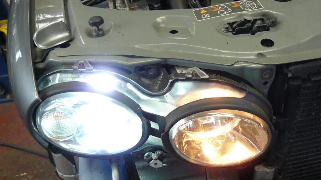

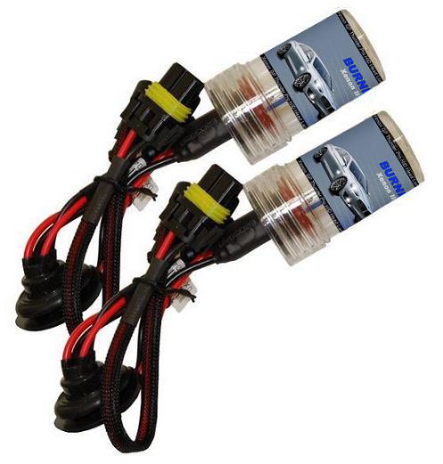

My Jag lights were so poor I fitted H1 Super White 6000K HID today.
http://www.hidlightsusa.com/product....=Pro_6K_H1_Kit
First of all I removed the front bumper; I have read on forums that you can get to the lights without doing this. I took one look at the tight space you have to work with and decided to remove the bumper. The Headlights are a simple job to remove once this is done and out the way.
The HID lights are a simple plug and play fitting. All you have to do is drill a hole in the rear cover of the dipped headlight, I used a Step drill bit for this (Don’t be alarmed the rubber grommet that comes with the HID kit makes it a water tight seal). I fitted the ballasts on the shelf area just below the headlamps and secured them by using the exterior mounting tape and tie wraps. Job Done!

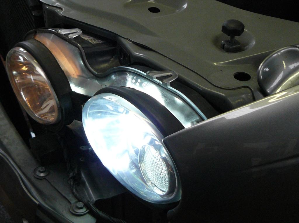

The yellowish sidelights spoiled the cold, clean, intense-white look of the xenons so I change these too with whiter sidelight bulbs, because they are on all the time with the xenons it just gives a nicer look and distinct improvement me thinks!

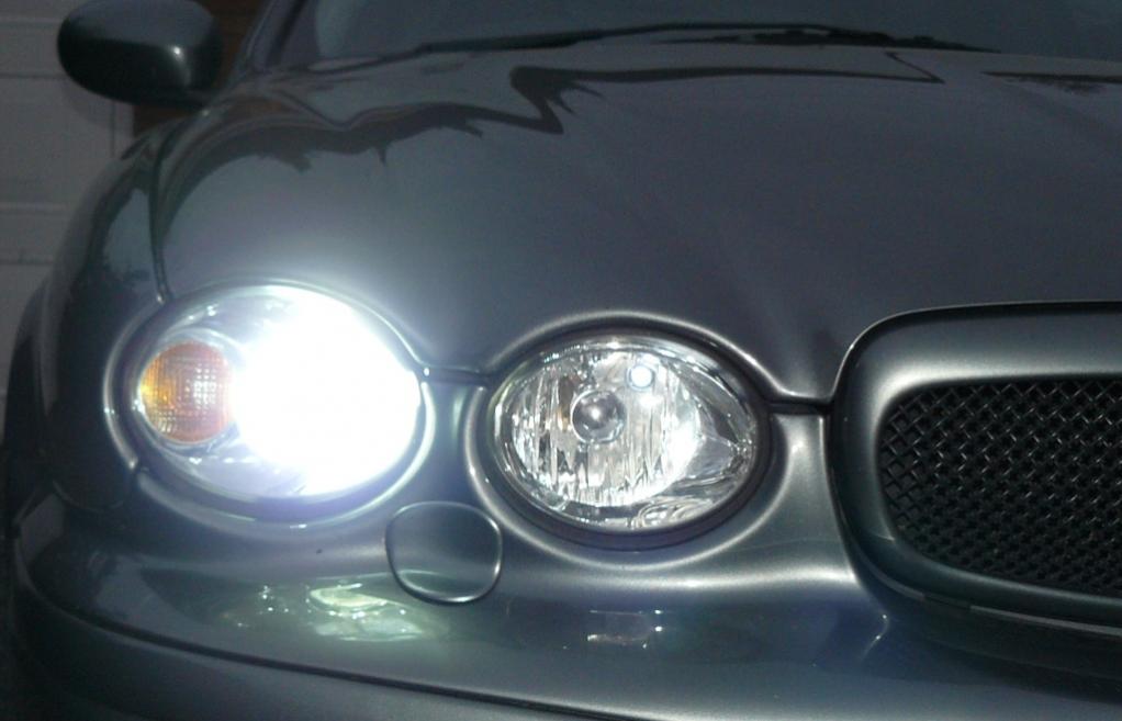

Job Done!
