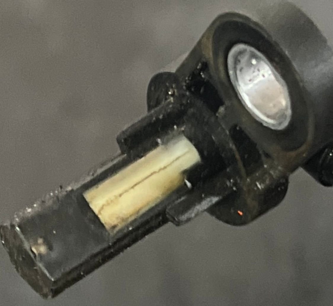

luckily my issue WAS the sensor. new one in and codes erased on their own after moving the car 50 feet.
sensor even looked bad
