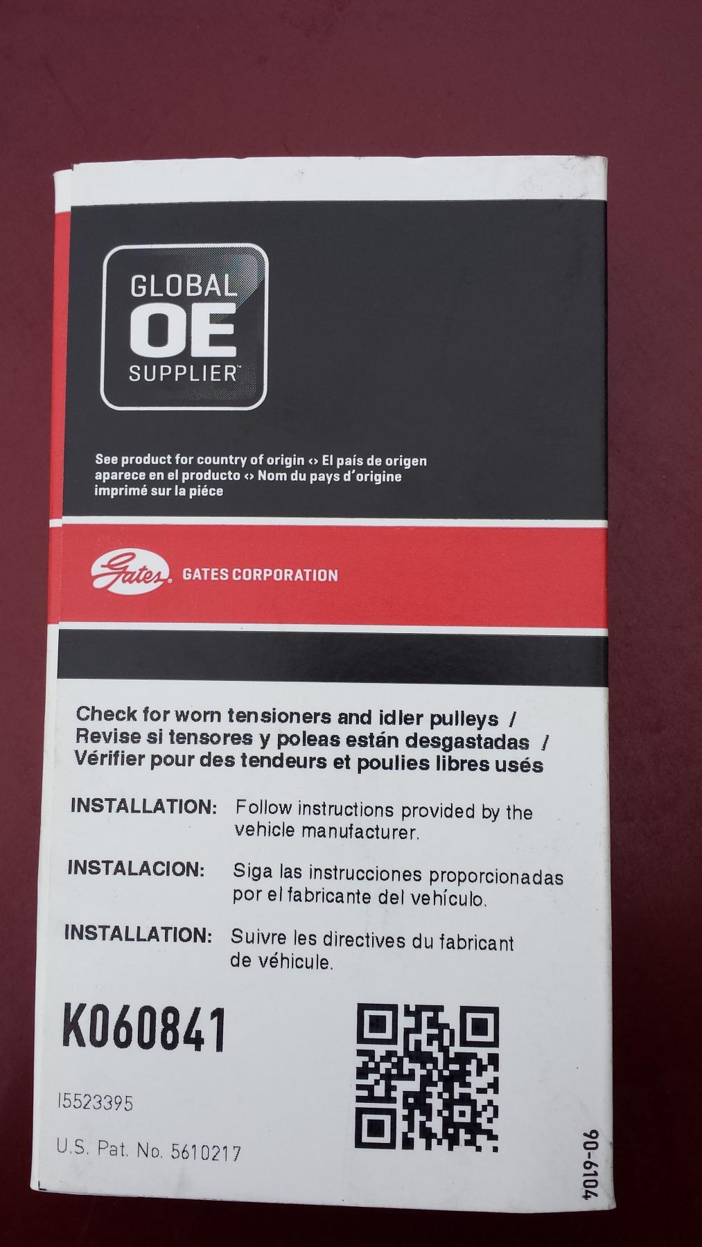

My A/C compressor just froze up and snapped the belt. I've had ac problems anyways so I tried this to bypass it and it worked. Thanks!!! Here is some info on the belt I used in case somebody else decides to do this because it took the pros at O'Reilly's a while to figure what I was doing and also find a belt.

Has anyone tried a Gates k060837? It is 84 1/4"... 3/8" shorter than the k060841. Just a thought since my Jag started squeeling a little. I put belt dressing on it and it quit, but considering going with this alternate belt.

This belt works much better for us. I live in Wisconsin and since it dropped below 0 degrees, the squeeling was terrible. Put this belt on and all is good.
