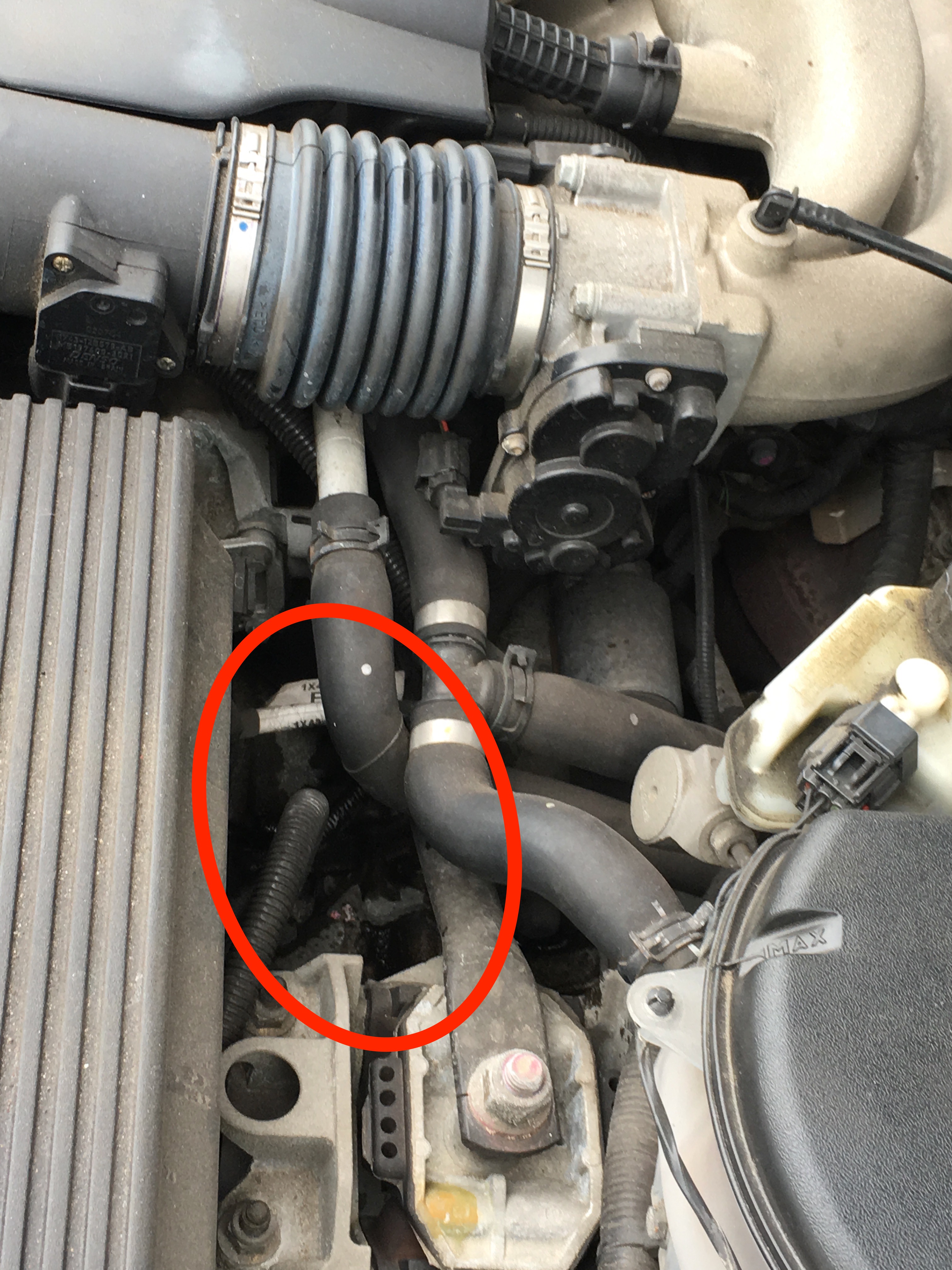

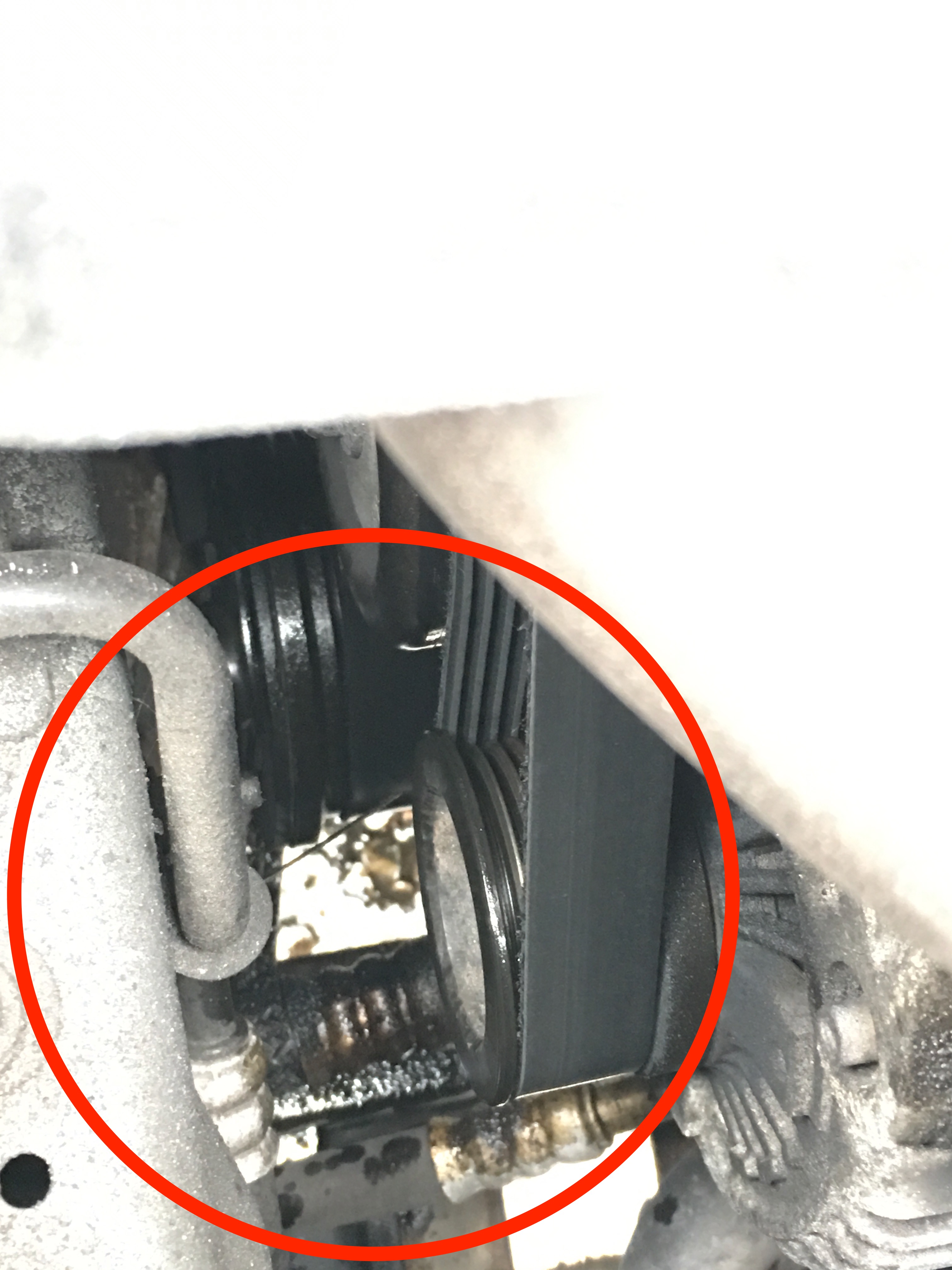

I pulled on to the hard shoulder and waited whilst the oil burned off - when I looked there was oil visible on either side of the engine (attached photos) and oil on the ground

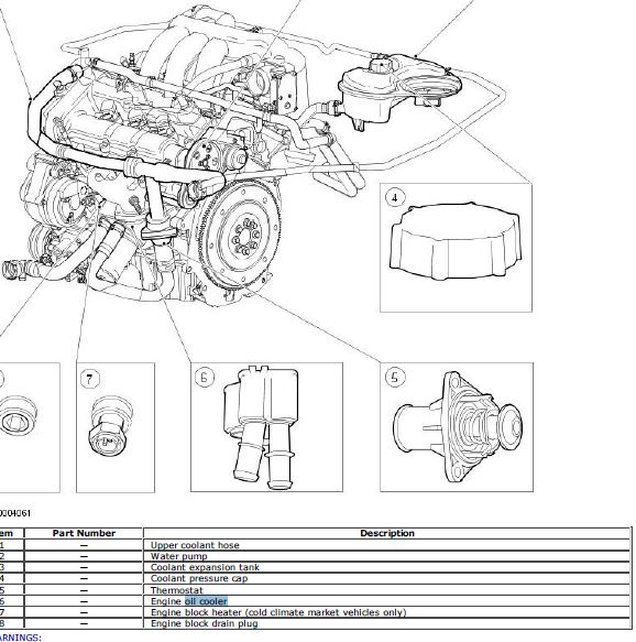

It sounds as though you have had an Oil Cooler failure. The attached jpeg shows the cooler and its location. The first thing to do is assess the current engine condition.
1. Is there any oil in the oil pan at all?
2. You need to do a cylinder compression test.
If the results are NO oil and low compression, I would start looking for a new engine. If you have compression and there is some oil remaining in the pan, you can try topping everything up and attempt to start. Any bearing noise would be another indication of time for a replacement engine.

Thank you both for your input. I had a good root around and even had an ex Jag mechanic come look.
There is little or no compression on all 6 cylinders, coolant leaking fast, oil forced out of the engine in all directions, radiator split on the side, thick burnt oil in the air intake tube, etc.
Without dismantling the engine we reached the conclusion that it wasn't worth repairing.
