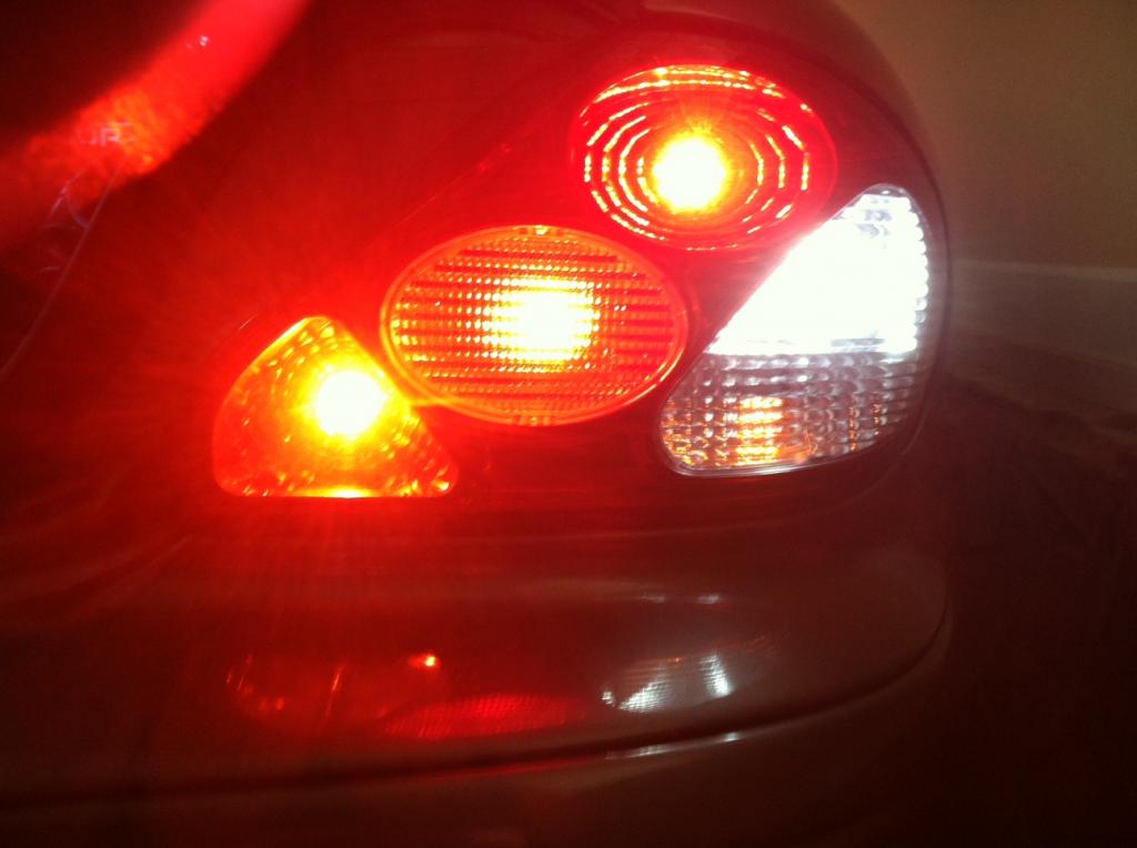

Not really doing much with Jag lately. changed all bulbs over to LED on rear lights finally
ill get some pics later tonite when its dark

Are those before and after pics?

No it's all LED pics

Looks great! I love the look of the LED's, and the light they put out is a lot more "crisp" looking than just the regular incandescent bulbs. I spot a Cree reverse light; I have a set and adore them. They only concern I have had with going full LED is brightness issues. Have you had any trouble with brightness?

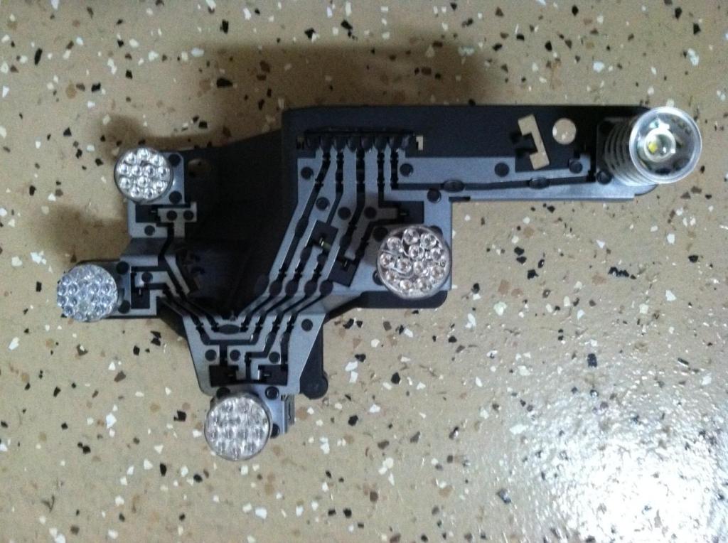

Did you have to install a new flasher or resistors for them to work properly with the car?

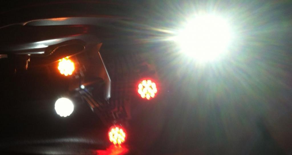

I actually went with it in the rear fog light socket. And put 19led on the reverse socket. It is a bright intense light but just in a straight line. The 19led gives you more lighted area on sides.

U do need resistors if u want the dash turn signals to blink at normal speed instead of fast like a bulb is burnt out
