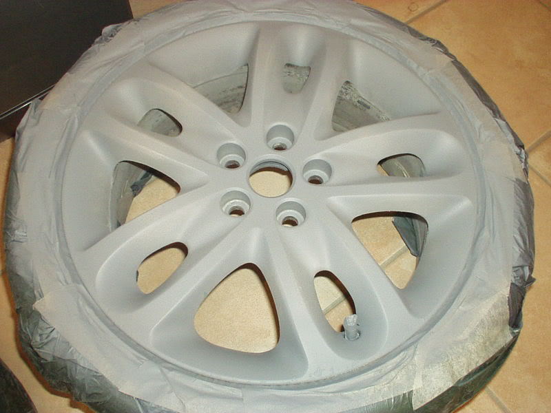

I decided against taking the tyres off the rims mainly to save time. So, I spent quite some time using the masking tape and some bin liners to mask off the rim from the tyre ( quite effective it seems too )
Wheel masked ready for Nitromors
Then, the time saving technique. I applied the Nitromors mousse to the rims to remove the paint , lacquer as much as possible. The biggest problem with the rims seems to be the paint bubbling everywhere. So rather than sand, sand, sand I sprayed on and left overnight for it to do its job.
The nitromors worked well on the bubbling paint and stripped it right back, however, it was overkill really and I don’t know if I’d go down that route again!
Turns out I’m quite lucky really as the rims only had slight scuff marks and no REAL damage, so filler, it seems is not going to be needed. That can go back and save me around £10
After the nitromors did its job it was time to use the Wet n Dry 120 coarse grit. It took a while but seems well worth the effort. Then a quick going over with the Wet n Dry 800 fine grit, followed by fine contours sanding pad.
Masked them up all over again and applied 2 coats of primer, leaving around 30 mins between coats. It recommends 15 mins minimum so I just gave it a little longer to be sure.
2nd coat primer

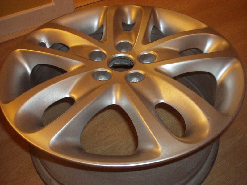

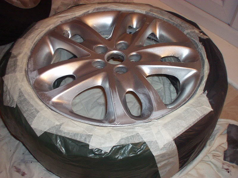

I've just finished the 2nd coat of silver alloy paint and although they look pretty good I'm nowhere near 100% satisfied with them.
However, I'm gonna carry on and lacquer them and fit them onto the car as soon as possible. The reason for the rush is that one of the wheels on the car is slightly buckled and causing vibration thru the steering. I want to get this off the car ASAP as its the wifes daily driverThis will allow me to get the original set off, which, when done,will be perfect. I will be taking my time with these and have learned that the key is in the preparation ( no doubt about it )
The tryes will be comming off the rims this time too for sure
These babies will be sanded down to a smooooth finish from starting the process right thru to the end.
I reckon that once these replacements have been lacquered and fitted to the car though that they will look good, just not as good as I want them to be.
Then when I have refurbed the originals at my leisure and to my complet satisfaction, the replacements will be back off and redone to perfection.
Anyway
Heres a couple of pics of two of the wheels with their 2nd coat of silver alloy paint for you to judge.
I suppose you really have to imagine them on the car c/w centre caps and wheels blackened to complete the picture though!
Jim

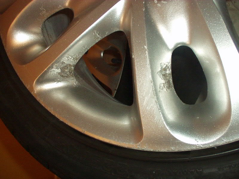

Well guys, I've just finished the lacquer coat on the rims and they're about ready to fit onto the X.
I gotta say that I'm not at all happy with the way that they turned out, but, in my defence, its been a rush job while doing tooo many other things.
I'm gonna go ahead and fit them, they will look great from about 2 feet away, so they'll do for the time being.
It'll allow me to get the good rims off and really do a number on them 150% on these babies. Once completed, they'll go back on and the replacements will be revisited and done properly, however long it takes.
I'll take pictures when they're on the car if I get the chance.
Just dont be too hard on me boys[&:]
Its been a learning experience, thats the good thing about it
Jim

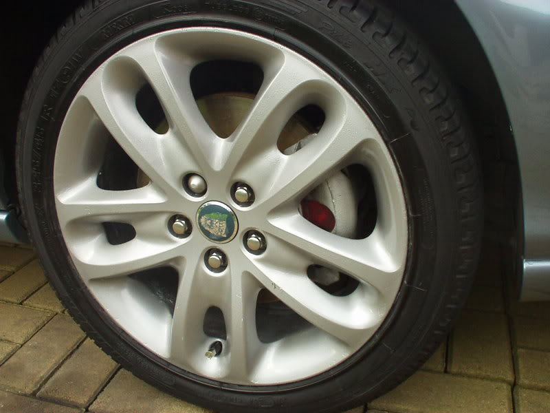

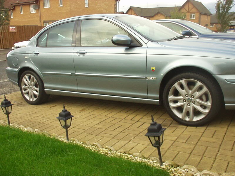

Here are some pics of the refurbished alloys on the X. I gave her a good clean today and she was lookin good so I thought I'd take em as I said I would
Jim

Looking good, but hate to point out the obvious mate.

Nice one Biggie......I was wonderin who would be the first to spot it?
Only on for five minutes and she's done it already.......If it weren't a temp job I swear I would done time for her...lol

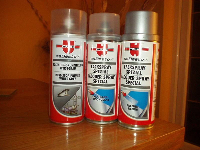

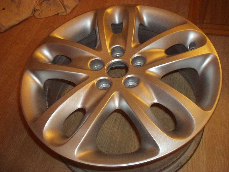

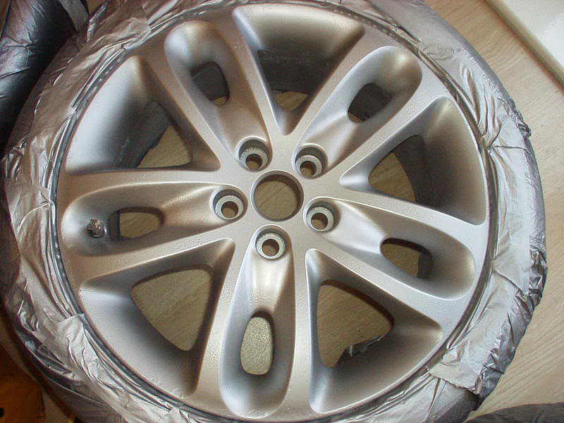

All my paint, lacquer n primer arrived from Wurth earlier today so I managed to get back onto the original rims
Wait till you see these results..........I think, they are absolutely awesome, as good as new, literally.
I'm not the best at these sorta repairs I will admit, but if I had to give anyone any advice on doing this job it would be this.
Sand, sand, sand and sand again....preparation will determine how good the outcome is.
Buy Wurth products as they are an almost identical match for original, they may be more expensive,but certainly worth it at the end of the refurb
Checking on the web I found the primer was around £7 and the lacquer and the paint £10 each. I contacted Wurth UK direct and they supplied me them for £5 each.....result!!!!
2 coats of primer on each wheel 30 mins drying time between each coat, followed by 2 coats of paint 1 hour between each coat. 2nd coat will be left to harden overnight, then I will follow with 2-3 coats of lacquer.
I swear to god my mouth is almost watering at the results
See below painted wheels still to be lacquered....150% improvement on previous refurb!
Products used!

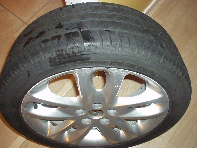

This is the worst wheel that had a major chunk sliced outta it by the kerb she hit!

Anyone wants Wurth products details listed below.
Highly recommended
Wurth UK Ltd
1 Centurion way
Erith
Kent
DA18 4AE
Tel 08705 987841
www.wurth.co.uk
Now, I cant wait to apply the lacquer and get the other rims off, calipers painted and wheel weels cleaned ( If I have time ) and these beauties back on the car
