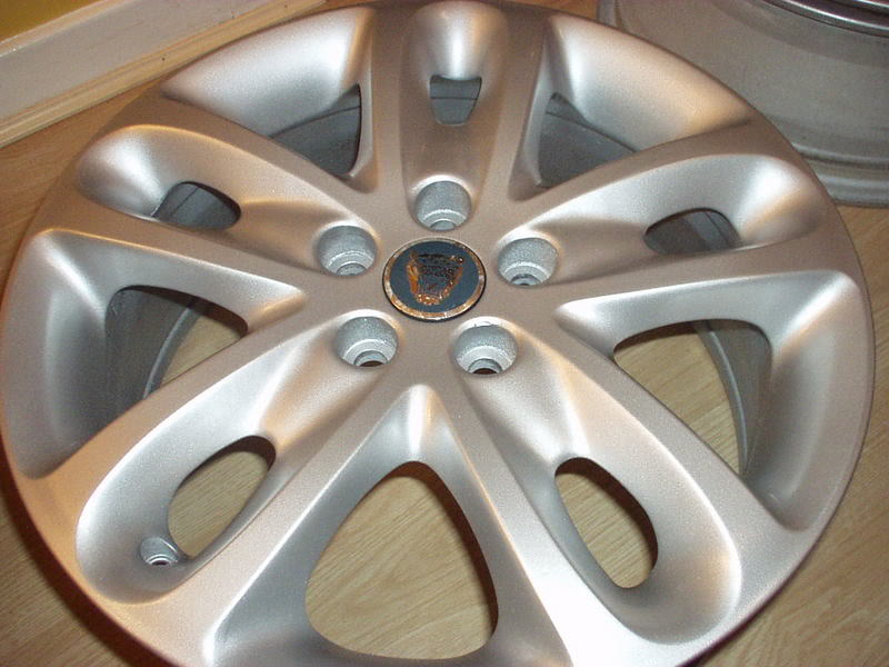

All my paint, lacquer n primer arrived from Wurth earlier today so I managed to get back onto the original rims
Wait till you see these results..........I think, they are absolutely awesome, as good as new, literally.
I'm not the best at these sorta repairs I will admit, but if I had to give anyone any advice on doing this job it would be this.
Sand, sand, sand and sand again....preparation will determine how good the outcome is.
Buy Wurth products as they are an almost identical match for original, they may be more expensive,but certainly worth it at the end of the refurb
Checking on the web I found the primer was around £7 and the lacquer and the paint £10 each. I contacted Wurth UK direct and they supplied me them for £5 each.....result!!!!
2 coats of primer on each wheel 30 mins drying time between each coat, followed by 2 coats of paint 1 hour between each coat. 2nd coat will be left to harden overnight, then I will follow with 2-3 coats of lacquer.
I swear to god my mouth is almost watering at the results
See below painted wheels still to be lacquered....150% improvement on previous refurb!
Products used!
This is the worst wheel that had a major chunk sliced outta it by the kerb she hit!
Anyone wants Wurth products details listed below.

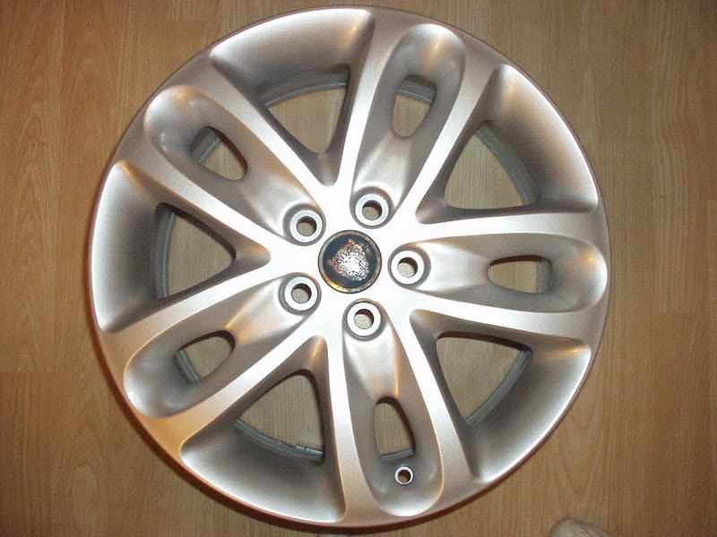

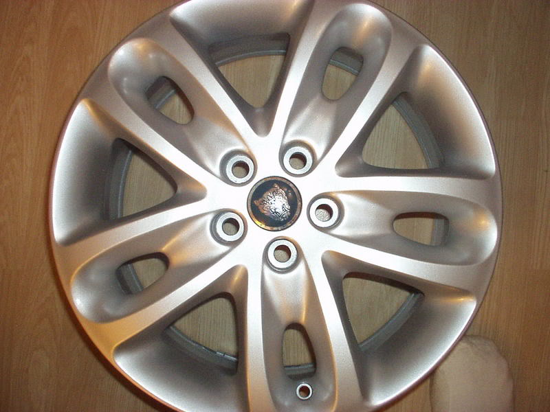

Ok….Here are the finished results of the alloys after complete refurb!
This involved 2 coats of Wurth white primer, followed by 4 coats of Wurth Silver alloy paint. When applying each coat I turned the wheels a ¼ turn each time as I noticed that with all the spokes n grooves some parts were getting more paint than others. I also noticed this after the “professional†refurb I had done on them a year ago.
Once done I applied 2 coats of Wurth clear lacquer again turning the wheel a ½ turn for each coat. Once the lacquer had dried a quick wipe down with Autoglym alloy wheel sealer to finish the job.

I believe having looked them over thouroughly that this is a much better job than the " professional " refurb I had done bout a year ago. Compared to new I'd say that these are about 99%, other than for the wear on the inside of the rim and where the tyres have been fitted you'd almost swear they were new.

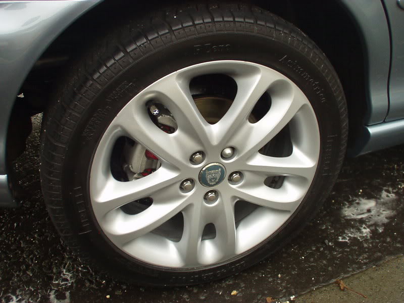

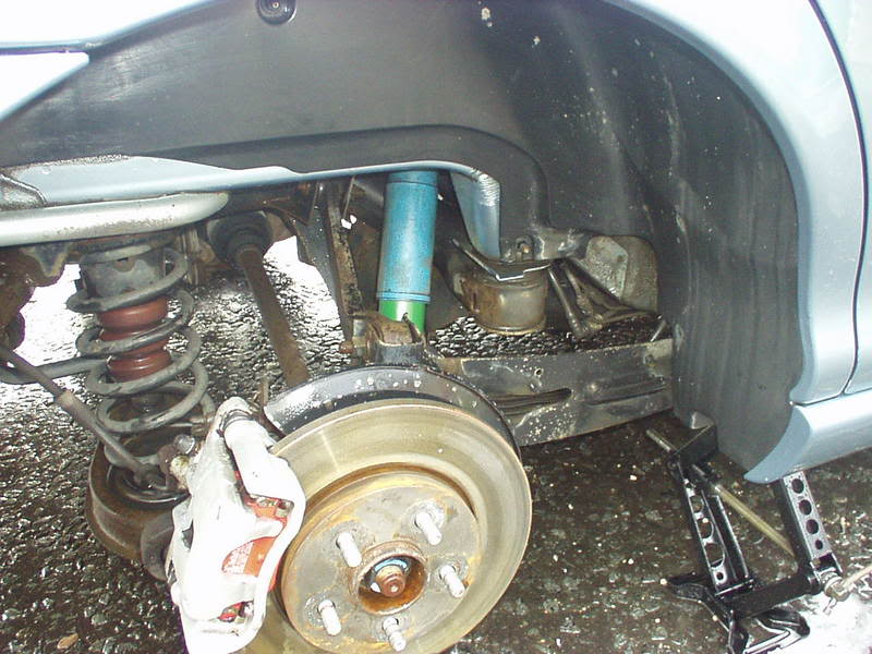

Finally got it finished.
Got the rims back from Kwik fit today with the tyres back on and balanced.
Took the car home and promptly inspected the wheels[&:]Bloody idiots had scuffed them here n there and I wasnt pleased. Anyway, managed to sort that out with a bit of T Cut and some elbow grease
Took the wheels off the car and cleaned the wheel liners and brake components, etc etc. ( I dont have time to paint them just yet - thats for later )
Applied Sonus total eclipse after drying them and buffed dry ( nnnnice ) cleaned the calipers and the Redstuff pads too
Fitted the tyre valve caps as previously posted and made sure that the growler centre caps were all staright n level ( its all in the detail...lol )
See pics below : -
Inner liner before 1
Inner liner before 2
Inner liner after 1
Inner liner after 2
Finished wheel on the car
