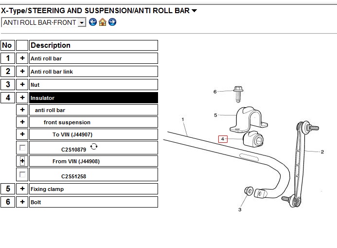

I assume he means the rubber insulators? There's an Anti-Roll Bar on the front:
And on the rear:
Note there's a P/N change with VIN.

I think this is the one he's talking about. Is there a top and bottom? He said it's the bottom one I need.
Old Apr 9, 2013 | 01:58 PM
He's being a bit obscure!
The Front Anti-Roll Bar (item 2 in the following graphic) has the 2 rubber insulators listed in the Parts Catalogue extract I posted in #2 above:
The arrangement for the Rear Anti-Roll Bar (item 9) is similar with 2 rubber insulators:
Neither could be described as 'top' or 'bottom'
