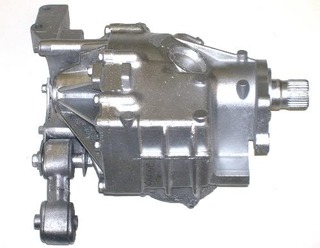

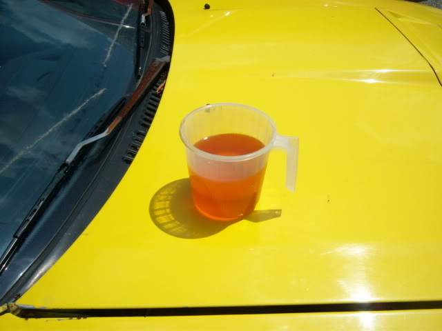

this is the fluid in an average transfer case 200-300 ml of dark burnt fluid
clean fuid above

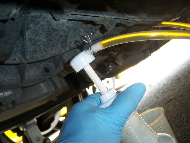

this is all you need

Very interesting, so you can topside it. How often do you change it? Do you remember where you got that pump - looks like a nice one.

They suggest it gets changed @ 60,000.. I just had mine done on Friday @ 56,000 and it was just dirty.
While talking with the shop owner he said not to launch the car hard or spin the tires. You stand the chance of destroying the clutch and damaging the transfer case. Its a Jaguar so its not meant to be drag raced or spin the tires for fun like a muscle car.
