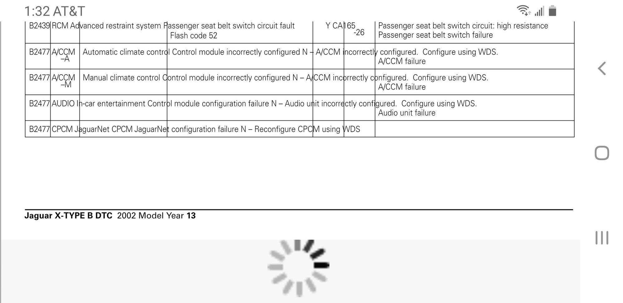

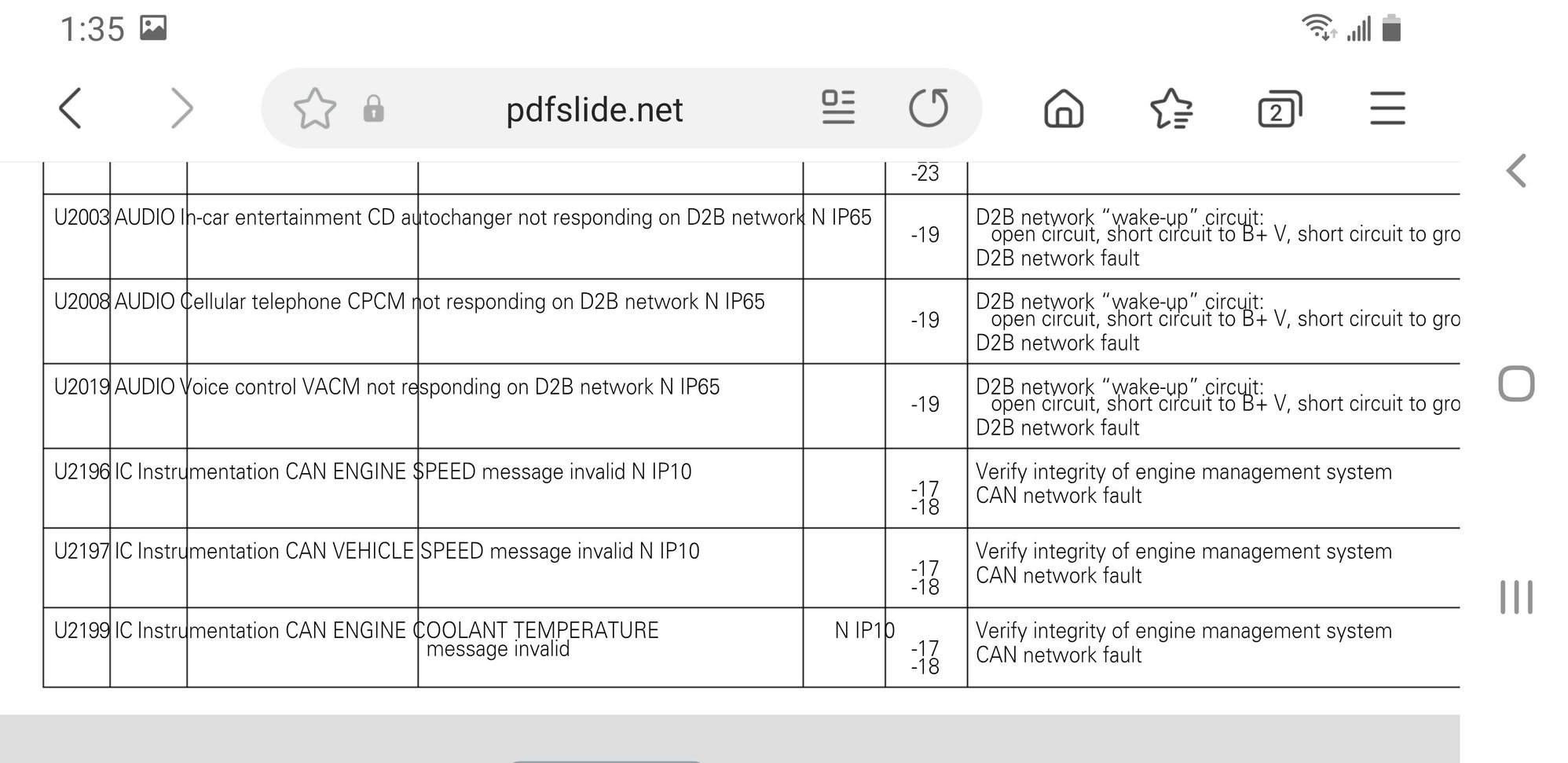

There are a few causes for the b2477, with u2008 take a look =
Old Sep 18, 2021 | 03:11 PM
gijoe50000's Avatar
Joined: Mar 2021
Posts: 125
Likes: 12
From: Ireland
Nice one. the first fault code, regarding the GECM on second page here, sounds the closest to the fault I'm getting. I'll give some of those systems a look over tomorrow.
The automatic wipers did seem a bit erratic alright today, but they're not always 100% accurate anyway, and it was raining/not raining so I put it down to them just not knowing what was going on.
Thanks..
