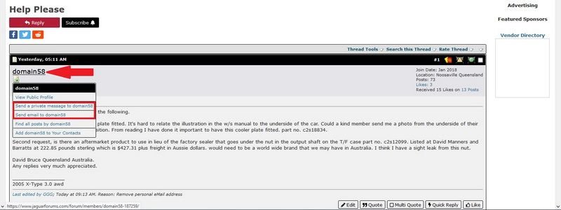

Old Sep 18, 2021 | 03:24 AM
David,
I've removed your eMail address from post #1. No need to give spammers who trawl the web looking for personal data a helping hand by putting this on a public forum.
If you need to communicate directly with another member, use either a PM (Private Message) or forum eMail. Click on a member's name in any of their posts to open this dialogue box and choose Send a private message to ..... or Send an email to ..... as appropriate. I've used your post as an example here:
Other members can communicate with you directly in the same way. No one can see PM's or forum eMails apart from the sender and recipient(s). Safe and private.
