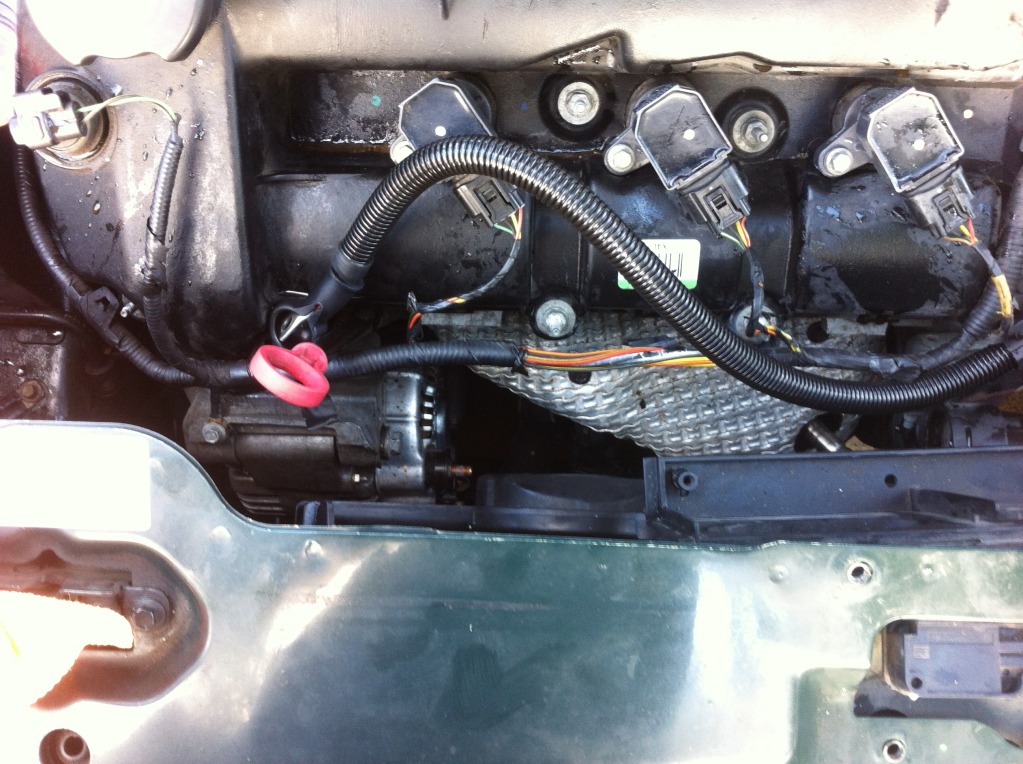

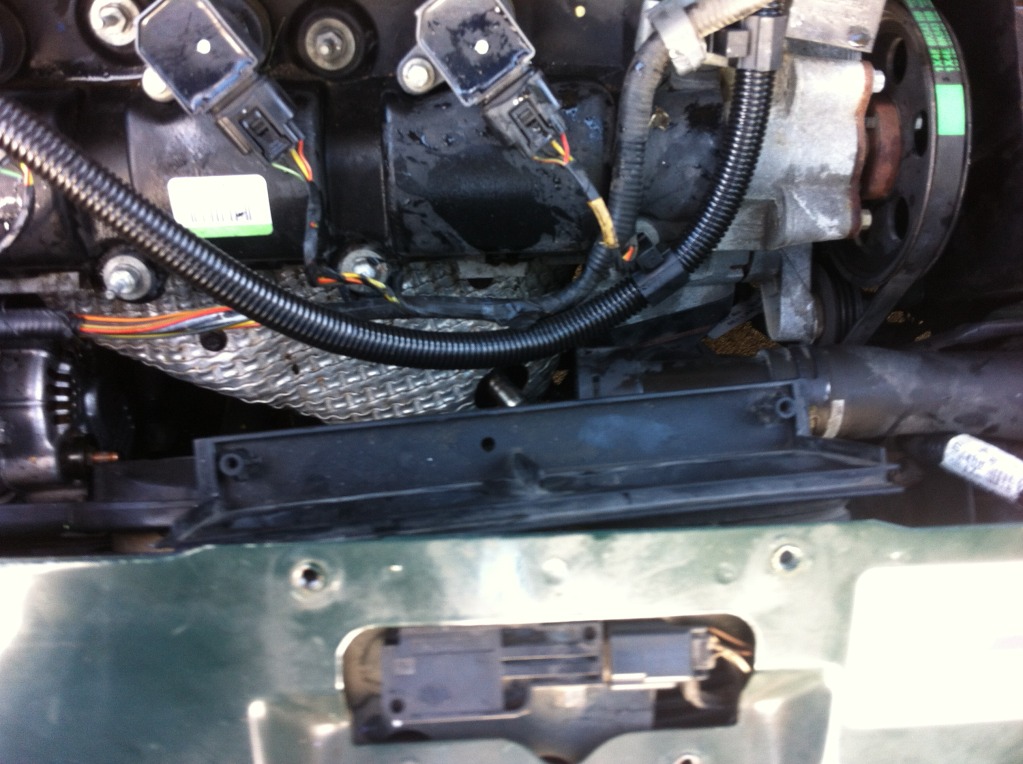

Well, I am planning on doing this over 2 days because it is very unpleasant. I am halfway to taking the alternator out:
I wish I would have taken the car in for this. I have tins of stuff of and probably need to take out more

Spend a full day trying to remove the alternator and all I got out is the bottom bolt. Of course I got the coolant hose, air box etc all out, but at this point that top bolt is stripped and I am going to have the car towed to the mechanic unless I can get that bolt if this morning. Even if manage to get the bolt out I would still have to take the fans out, it's just like the whole car was built around that thing. I enjoyed changing the spark plugs and changing the transmission fluid in the car, but this is brutal,
