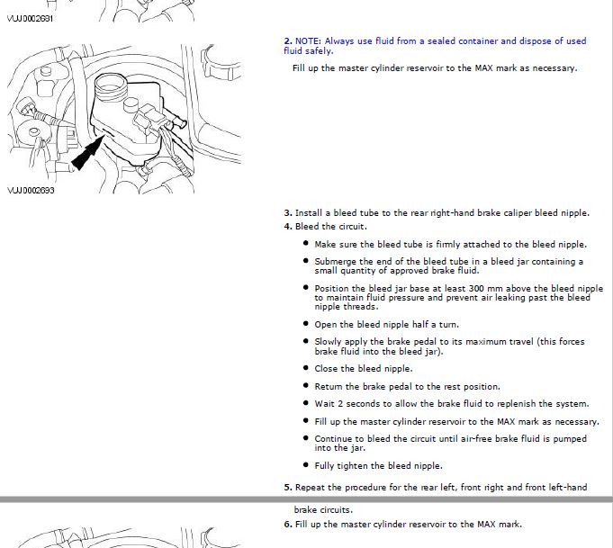

Attached is the brake bleeding procedure frm the tech manual. It lists the sequence and method.

It is furthest by line length from the ABS unit, rather than the master cylinder...RF has a pretty big loop to balance out the run.
