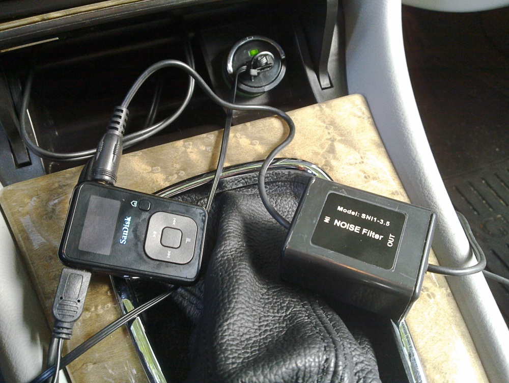

Why do you need to stream music from the phone btw? I for example have an AUX lead soldered to the original head unit (based on current knowledge only works if you have the cassette player) and a dedicated mp3 player hidden in the ashtray connected to it. It starts playing when I start the car and stops playing when I stop the car. The AUX connection is CD-quality. While this is not exactly a very high-tech solution, keeping the interior stock-looking is something important for me.
