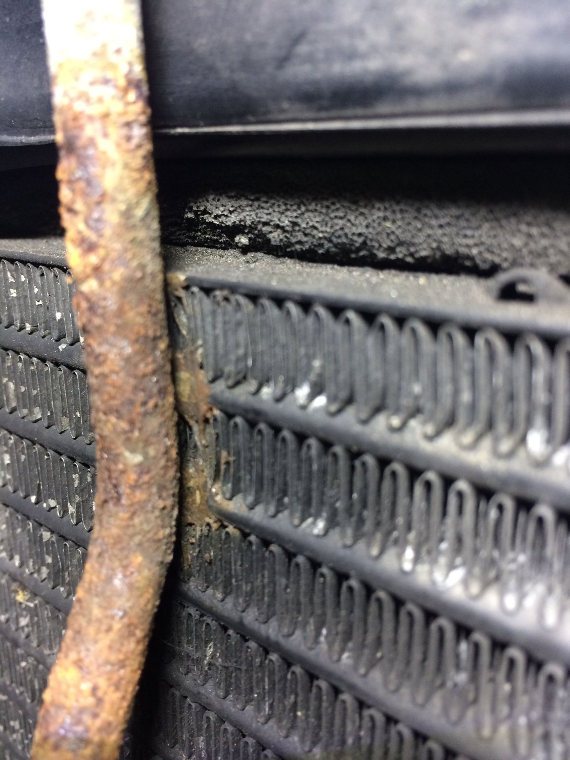

Bonnet latch hammering the rad?

Do I need a new radiator?

Not yet but maybe soon. I would clean off the rust and paint. Then make sure it is not hitting the radiator. You may have to bend it a bit or adjust the stop.
