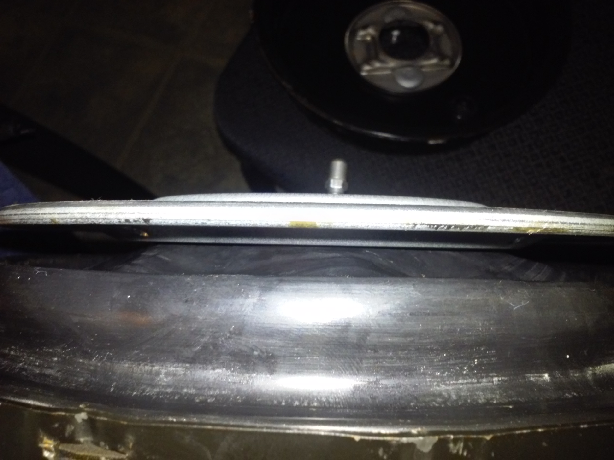

I figured it out. The clip is a piece of metal with a rubber inset with 2 channels above it for the pipes. The rubber insert simply slides over a stud mounted to the firewall, Simply pull it forward and it slides off the stud. Duh!
Also I found out how to fix the brake booster. The rubber diaphragm slides off the canter plate. This prevents the master brake cylinder from retracting fully. simply sliding it back on fixes the dragging brake problem. I will post pics.
