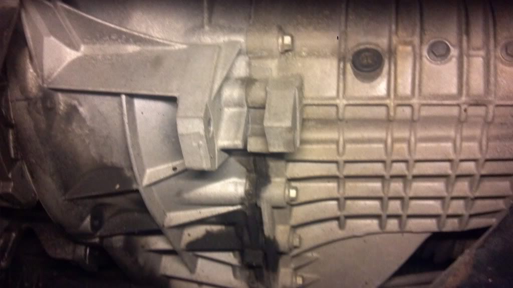

Now locate the drain valve. The picture below is of the drain valve and the wheel is the right front wheel just to help with orientation.

faltwen, if your xtype is a manual, the drain valve will be in the same location as it is in this picture. This picture was taken facing the right front wheel on the car. Name:  2011-10-30_17-31-09_836.jpg
Old Jul 31, 2012 | 08:20 AM
faltwen's Avatar
Posts: 56
Likes: 19
From: Sunny Scunny UK
Finally spotted it - here in the uk right front wheel means the right as you are sat in the car. I was looking in the wrong direction!
Old Jul 31, 2012 | 05:34 PM
disguay's Avatar
Joined: May 2011
Posts: 1,109
Likes: 172
From: fort collins, CO
my bad, I do not know why I said front right. I meant to say front left as in the driver side of the car for US models.
