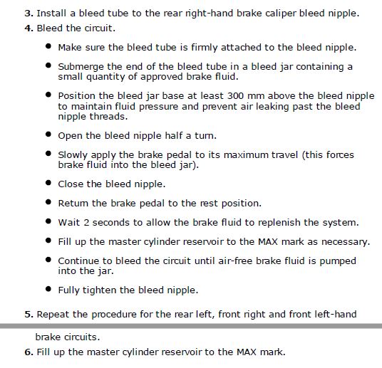

+1 on Thermo's comments. In addition to his recommendations you will also find the Jag brakes are bled in a very specific sequence. I have attached the steps from the workshop manual.
