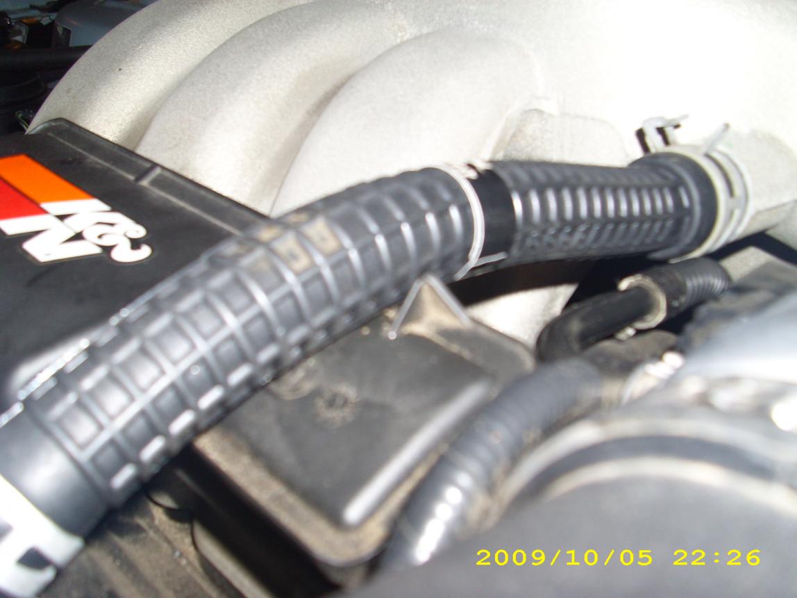

just got in my parts, new spark plugs, intake manifold gaskets, throttle body seal, and cabin filter. also bought a breather hose and it came in as well. instantly i knew that the new one was different. the new one is the same exact shape, however it is not a smooth outside texture, instead it has a raised waffle pattern. hose is still the same thickness, it seems. im thinking they added it for extra strength as it does bend to connect. i think it looks cool. anyone else seen this?? -stevis05

Everyone that has had to replace it due to the three inch split along the bottom of the original one...

Yeah, its been stated the new one is much sturdier than the old one to make it less likely to split

part number is 4X4E-6K817-AC for the old one and updated one had 4X4E-6K817-AE
i ordered it from partsgeek.com for like 11 bucks think. -stevis05

The waffle hose came standard on my 2005 X-Type 3.0.
I'm guessing Jaguar updated the part after the first couple of model years to address the known issue of the breather hose cracking. I'd read somewhere that nearly 1000 parts had been changed on the X-Types between 2002 and mid 2004, in response to initial reliability issues. If that's true, it's going to be impractical for us to try to come up with an exhaustive list in this thread.
