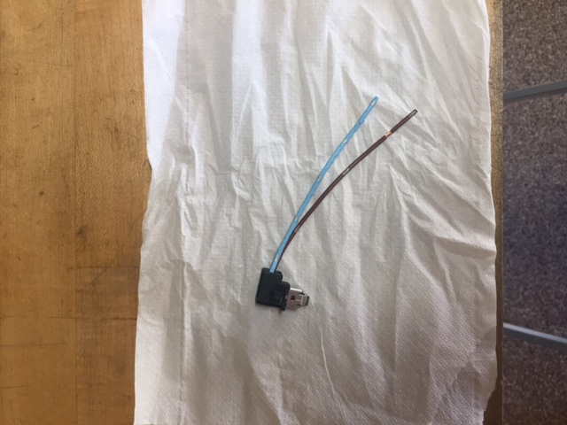

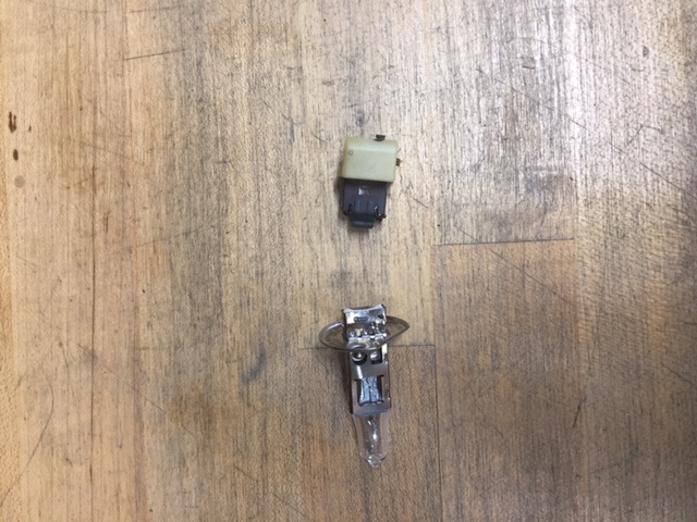

I recently had a bulb go out, so thought it'd be pretty easy to replace. Wrong. Found that the old bulb was fused into the socket, so simple bulb replacement morphed into having to replace the bulb socket (found inexpensive pack of four sockets on Amazon by the way). However I also found that my headlight adjusters on both sides are broken; most likely yours are too, as this failure is darn near guaranteed with this Hella assembly. I had to do the same repair on my E39 BMW. I'm now waiting parts coming from England for the X-Type. There's YouTube repair videos available. The adjuster replacement involves removing the headlight assemblies from the car (front bumper cover has to come off), then disassembly of the headlights to replace the adjusters. I'll post some pictures when I do mine. The good news is that this Sylvania bulb is brighter (not installing the second side until I undertake the adjuster repair). I paid $15 USD for the pack of two, also from Amazon.

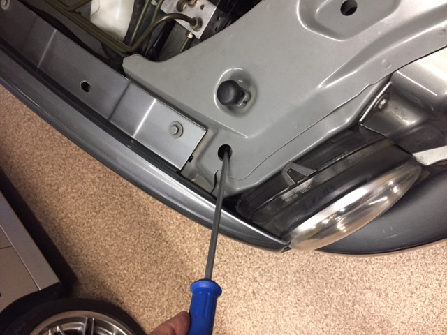

One other thing about securing the covers on backside of headlight assemblies. They're held on by two spring clips; the inboard clips are very accessible. The outboard (fender side) clips are another story, as there's not a lot of room to get purchase. I found putting a screwdriver through the adjuster hole works great to pop the clip back into place. Put a flashlight behind the headlight and you'll see the clip clearly and where to place the screwdriver.
