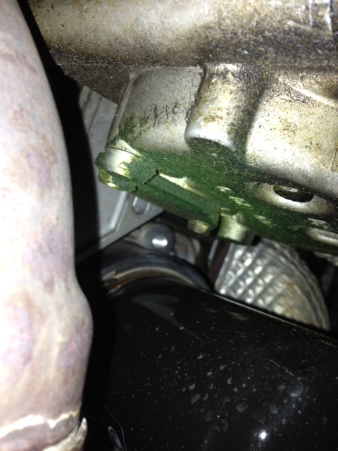

Hello All!
I was checking things out on the underside of my X this weekend and discovered a leak in the A/C compressor. I'm very familiar with compressors, so I was wondering if it's something that can be repaired or if I might need a new compressor.
Thanks!
Attached Thumbnails A/C Compressor Issues-photo1_zps3fbed14f.jpg   A/C Compressor Issues-photo2_zps44eaefd6.jpg

Lovely.
I had the same problem. I replaced the compressor. It's the quickest, easiest way.

To add my $0.02 here - the first pic looks like the leak is from where the two halves of the compressor are bolted together or from the clutch seal - in either case - the compressor should be replaced as at this point - with that kind of leak - the compressor oil is more than likely gone and the internals will just chew themselves apart.
In the second pic - if this was the only leak you had - you could change the O-Ring seal - only $11 - but again, you have a major leak as I stated above.
Finally, those seal kits would not work in a situation like yours and I for one wouldn't trust letting that stuff into the AC system - more trouble than what it's worth.

Thats too bad a leak, replace it
Agreed.
And I don't ever EVER use that seal leak stuff. I did once and had to pull the system apart later anyway (cause it didn't seal anything). That was the biggest frappin mess to try to clean that stuff out of there.
