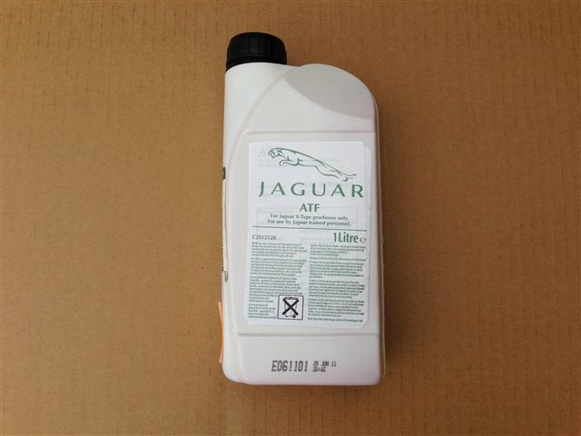

Have the tranny flushed and put REAL Jaguar transmission fluid back in it.
It is different than other fluids. The computer is "tuned" specifically to real Jag Juice.
(There is a reason it ain't cheap)

Perhaps you are right, but searching the archives I see that many members have used the Castrol Multi Import fluid successfully. If this fluid is indeed 40 dollars a quart, it would be a very expensive experiment. Specially if the problem is a bad sensor or God forbid, mechanical.
I hooked up my life OBD 2 sensor reader to my car to see how things where doing while driving and I noticed the TPS value would most of the time be 4.3 at stops. Sometimes 3.9. A couple of times 4.7. After I filled up the gas tank, it seemed to stick at 5.1 for a while . Don't know if that's normal.
