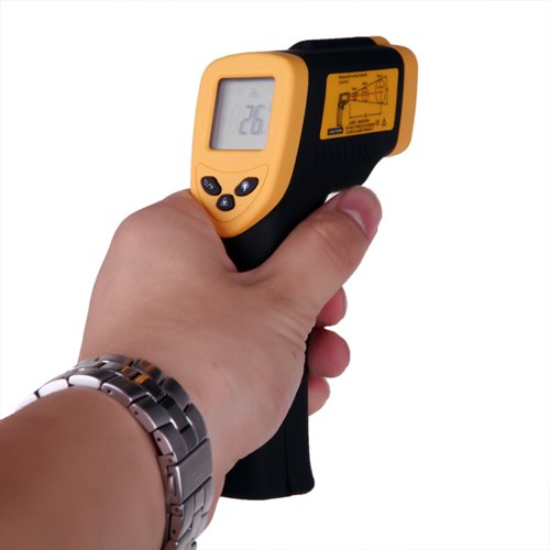

Buy one of
<i>these</i> these
. (A Non-contact Infrared Temp Gun)
I purchased one specifically to look for problems with my cars and truck. You just aim the laser pointer at the part, and read out the temp.
For under $17 USD, this one is a steal. My experience is that it is exceptionally accurate.
If you're losing a wheel or drive-shaft bearing, one the brakes are aren't releasing, or any of a myriad of things - whatever is bogging you down will likely be the result of friction - and friction causes heat.
This handy little gadget will find it.
If it doesn't, you will know you're on the right track with fuel or electrical.
It has a lighted display, so you can hop out in the evening and use it, and it really really does work as the purrfect kat toy.
Question, Spikepaga: What happens when the car is feeling "boggy" if you let go of the steering wheel?

@ Bruce in ND
Thanks for reply. I do have a laser thermometer for my other kittens. It's a great tool to have. I will try it tomorrow on the X.
I have noticed no difference if I let go of the wheel when the car is feeling heavy. Why?

Spikepaga,
I'd just start shooting at parts with the infrared thermometer and looking for parts or places that are hot. Don't wait but just seconds after driving to check the temps - some things might cool off immediately when you stop to check.
Don't forget to check the temps and the pressures of the tires, too.
That pull to the right is a major clue, I betchya!
It might be something as simple as a wheel bearing that was just pre-loaded too much, and the cost will be nothing to just loosen up the nut 1/16th of a turn.
