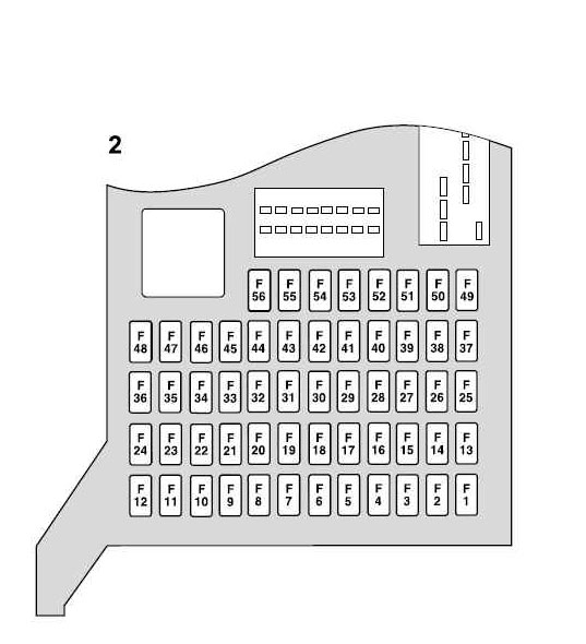

I would first pull the fuse out for a few seconds and put it back in. This might help reset something. I believe it is fuse #44 (behind the coin box). If that does not do the trick then hold the eject button in for a minute or two and see what happens. Can't remember if there is a light that flashes or not but if it does have one let go if the light flashes and then push it again right after. If none of that works remove the negative battery cable for a few and hook it back up and give it a whirl. You will need your radio code to do this though.

Thanks Daddylogan but I'm confused about "fuse inside the car behind the coin box" ??? I don't know that location. More guidance appreciated!

Ok....if your sitting in your car, to the left of your left knee should be a removable tray that hold items in the lower dash (down below your headlight switch on the lower portion). The inside fuse box is behind that. I might have the fuse number wrong...let me double check on that.
Correction...should be fuse F44
peace out,
daddylogan
Attached Thumbnails CD Player (single) Won't Eject 2004 X-Type-fuse-location-2002-x-type.jpg   CD Player (single) Won't Eject 2004 X-Type-fuses-2002-x-type.jpg

Thanks Daddylogan! I've had my car for more than 5 years and never noticed the "coin box" before! I'll try pulling Fuse 44 tomorrow and see what happens.

Thanks for the suggestion, Daddylogan, unfortunately, it did not do the trick. I removed and replaced Fuse 44 and now when I press the CD button, the display reads "CD Error" rather than "Track 00 0'33" so something happened - just not what I was hoping for.

After took out the unit and remove the CD, the radio is not played. Thanks dadylogan, I check the fuse #44, yes it's burned, Ireplaced the fuse but only radio is play, the CD still says "CD error", I guess the mechanism were messed up, now I think of replace whole unit with after market with touch screen, navigation, blue tooth and rear parking assist, can some one suggest what brand and wiring schemes?
