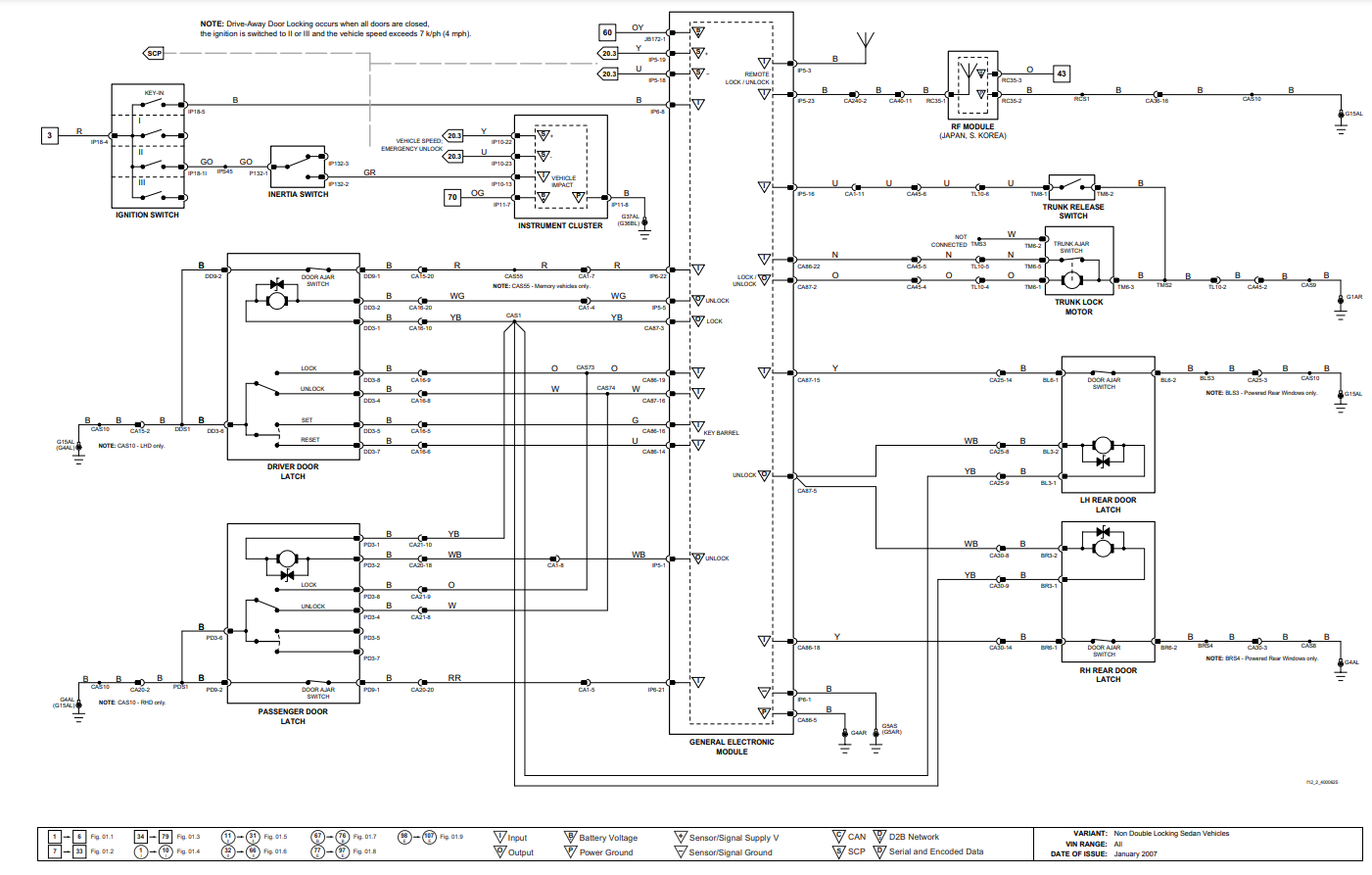

This is a very weird issue and I don't know what else I should look at as the culprit anymore. P.S. I did check the linkages on the drivers door to see if they were out of adjustment i.e. to see if they had skipped teeth over time, they had not. I should also say that the issue with not being able to lock the doors used to be intermittent but I could never point at what caused it to work and what didn't but recently it has stopped all together. Attached is the wiring diagram from the electrical guide. Any insight is appreciated. Cheers.

I would look at the two sensor lines that feed back into the GEM from the driver's door latch (CA86 pins 14&16), namely the ones shown as "Set and Reset" which appear to be momentary contacts to earth. If either is not activating properly or has leakage, it could be confusing the GEM as to the readiness state of the drivers door.

Looking at your diagram.....Double check that the "lock and unlock" switches in the both front doors are actually sending the correct "low" feedback to the GEM, indicating to their physical locked or unlocked status.
If either door is providing the wrong feedback, then the GEM could be confused.
Note: Only the drivers door has the set/reset momentary switch in the door lock being monitored back to the GEM.
