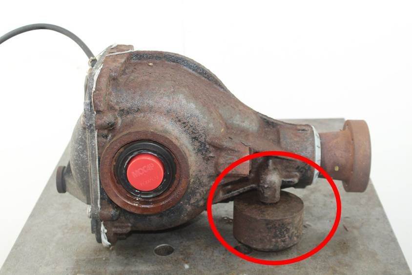

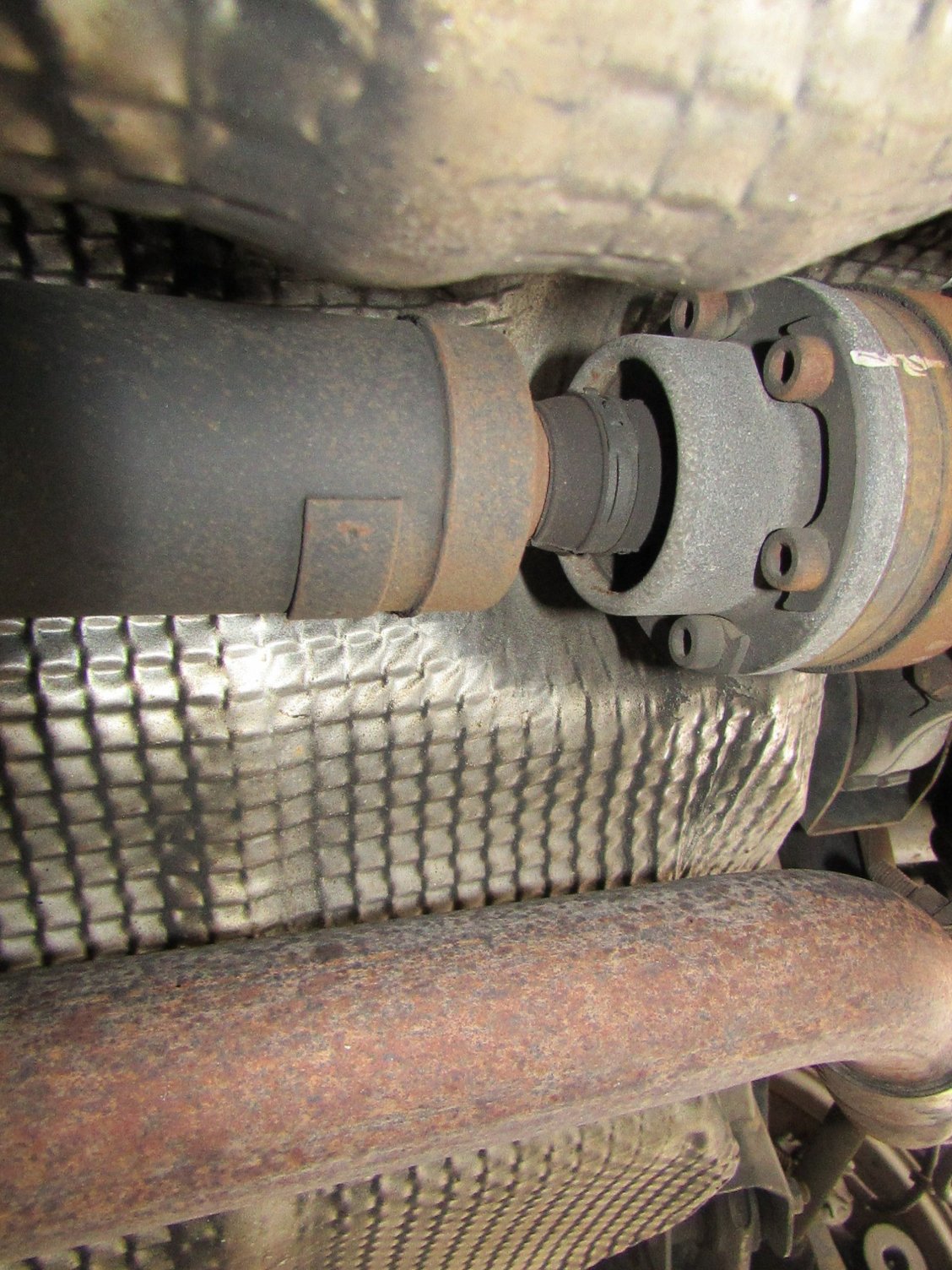

OK, just realizing your question is not related to the balance weight hung off the side of the rear differential. You are worried about the prop shaft balance weight that is riveted on to the shaft being larger than the prop shaft bearing, I think.
From your picture the balance weight is no bigger that the flanged end of the prop shaft so I cannot imagine it could be a problem. Some calipers should tell you what you want in a few seconds. I haven't done this myself. YMMV.
Below is what I thought you mean by prop shaft balance weight. My apologies.
