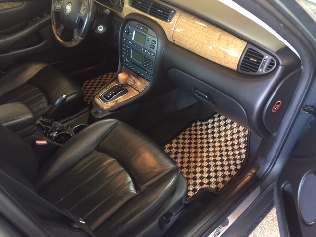

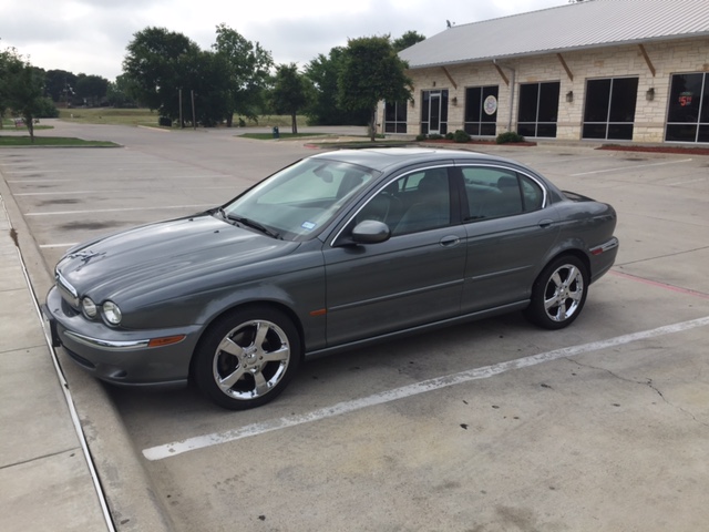

+1 on Thermo's advice. Put it back together and enjoy the drive. We just put on 3k miles on "Bridget" on road trip to Florida and back. She ran great and delivered average 27mpg. Have ordered parts for replacing hood insulation and the windshield defroster vents next week.
