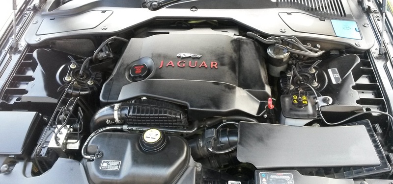

Here's mine under the bonnet XJ 2.7 Sovereign LWB

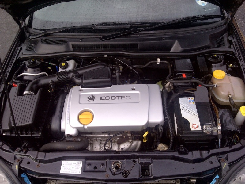

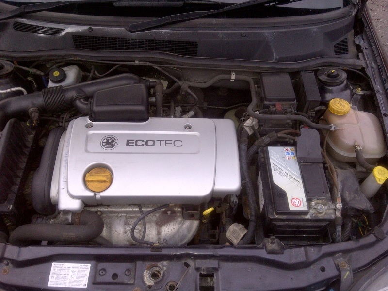

Here's Connor ( my sons Vauxhall Astra before
After....

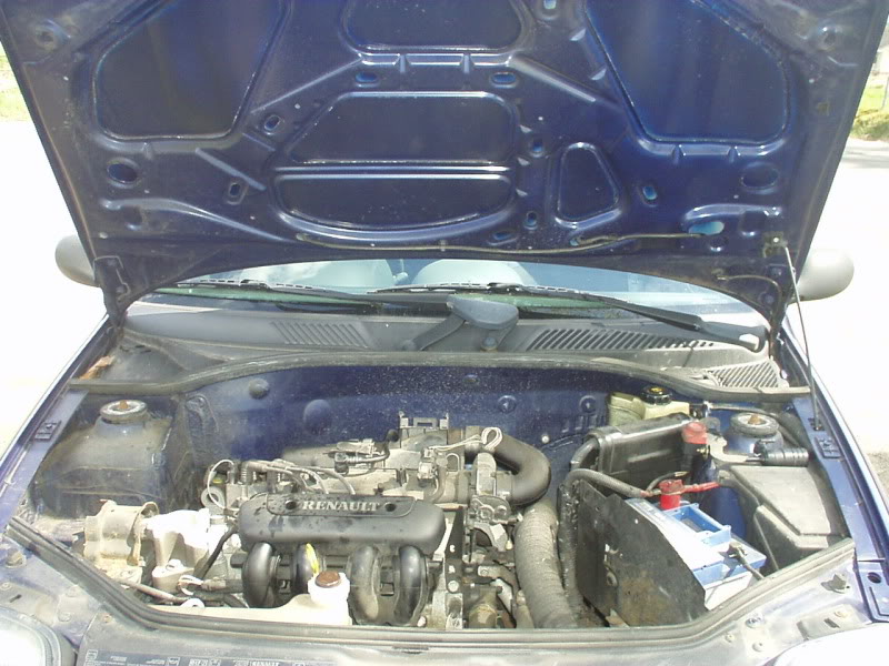

Peter's old Clio before...
After....
Do NOT use a steam / jet wash under any circumstances.
Only tools required are ......
1. patience and elbow grease
2. cloths / rags
3. Paintbrushes ( something like 1" and 2" )
4. Spray bottle of APC or degreaser
5. Spray bottle hot soapy water
6. Tyre shine type product
Start on the under side of the bonnet / hood, this is if you have a hood liner or not ( no difference )
Gently spray the hot soapy water and add a little degreaser to you cloth and work away, cleaning this area first, getting it nice and clean paying particular attention around the hinges and catches
Once this is completed you can start on the engine bat itself.
Spray the degreaser liberally around the worst affected areas, followed by some hot soapy water, then agitate with whatever size paintbrush is best for that area.
Best to start around the depths of the engine and work your way out as it were, using the same technique and once happy giving it a quick going over with the dry rag to wipe away any dirt / moisture etc
The brushes are particularly useful for small hard to reach areas.
Once completed and dried, you can add a spray of the tyre shine product and leave to soak in for a short time, before buffing it dry to a nice black shine on the plastics and hoses.
Shouldn't take more than an hour or so to get a really good clean engine bay, one you can be proud of and go from there.
On a side note, every time I wash the car, the doors are opened as are the boot and bonnet, all giving a quick once over......Once you've got it clean it's then very easy to keep it that way
Good luck
