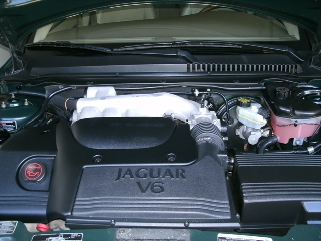

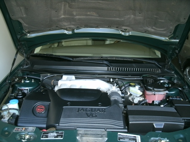

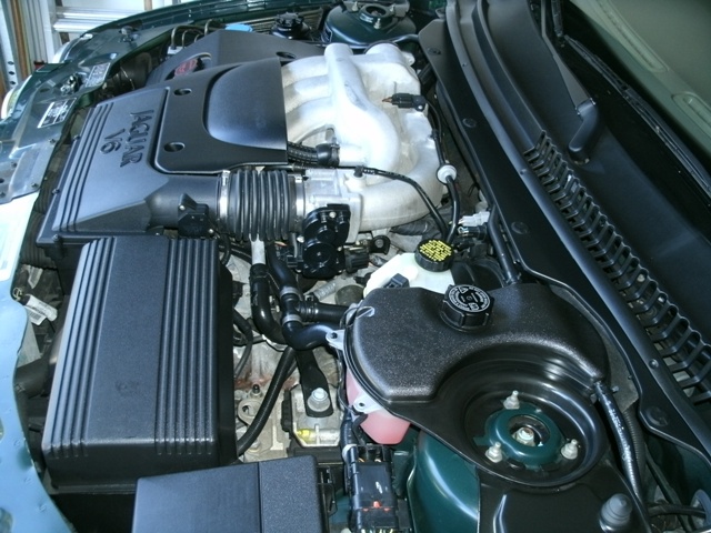

If the new tank does not come with a cap, can you use the one from the cracked tank? Thank you. (Since I have an X-Type and might have this situation in the future.)

As long as you think the old cap is sound and not leaking or popping off at a lower pressure...They do get weak with age..just saying.
We'll see if Oldpunk gets a cap with his..then we'll know what to expect..I'm pretty sure he'll get a new cap though with his new Tank.

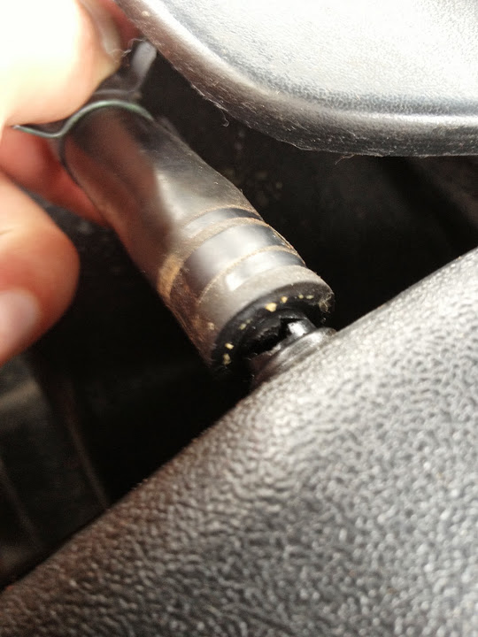

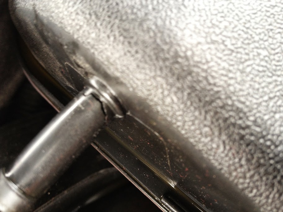

You guys were right again. The nipple off the side was broken. That's what was causing my leak everywhere. Replacing the tank was pretty simple, a bit messy though. The ebay replacement was absolute garbage. I needed to do so much trimming to all three hose outlets. The machining was just horrid on this. I'll be suprised if the hoses don't leak out of the outlets. The way they were shaped there's just no way the hose is going to seal well. Plus I had to trim out the holes themselves, there was so much plastic debris. Just a total peice of crap. Plus one of the tabs that holds the wires was broke off. I would have complained and asked for a refund or exchange, but I needed this thing like yesterday, so hopefully with all of the trimming I did, it will work out.
