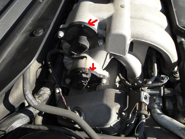

ok so when i opened my hood while the car was on i heard hissing coming from this side of the car(shown in the picture) and as i read dennis blacks thread on page six this one of the vacuum leaks that occurs

My question is what parts would I need to buy to fix this?

Klodjan91, those black pieces that have the arrows pointing to them are called intake manifold tuning (IMT) valves. There is an o-ring on the inside of them. If you go to your dealership, ask for 2 IMT o-rings. They are like $5 each. The top one is easy to do. Remove the two bolts, slide the valve out, pull off the old o-ring, slide on the new, tighten down. As for the bottom one, there is a clearance issue. So, you will need to undo the two bolts, slide the valve part way out, then grab on to the o-ring, stretch it a little bit to pull it off over the end. Then you can take the new one, stretch it a little bit to slide it back over, set the o-ring down into the groove and tighten down. Should take you but a few minutes to do this. You will need an 8mm socket to get the bolts off as I recall.
