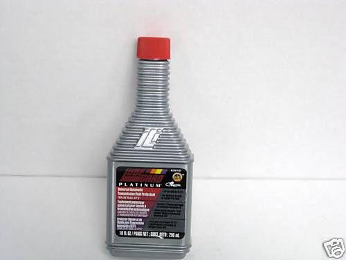

I'm assuming it's an automatic trans, if so you may want to try and get it serviced and add a bottle of Lubeguard Platinum trans additive. Almost all the transmission overhaul shops use this stuff as the additives can make a world of difference in shift quality and it also frees up sticking valves in the valve body. Never know, you may get lucky.
If you need to rebuild, dealer cost is going to be crazy high, so I'd recommend finding a good independent shop.
If it's a manual trans and it's slipping, you can nurse it for a while but it might not be too long before it leaves you on the side of the road.
My auto trans rebuild was just under $2k and the dealer wanted 3 times that much.
