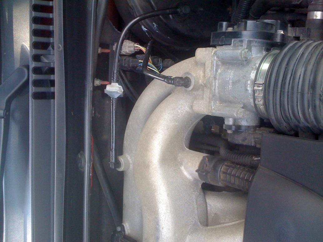

Question I found the noise
I found the hissing noise, but it's not coming from the hose or pipes. It's coming from a round white cracked plastic disk. I don't know what's it called but here is the pictures of it. does anyone know what it is and how to replace it?

Looks like the brake booster vacuum hose. Sold as a complete unit. That white check valve has deteriorated and is leaking. Simple to change.

Thank you very much
