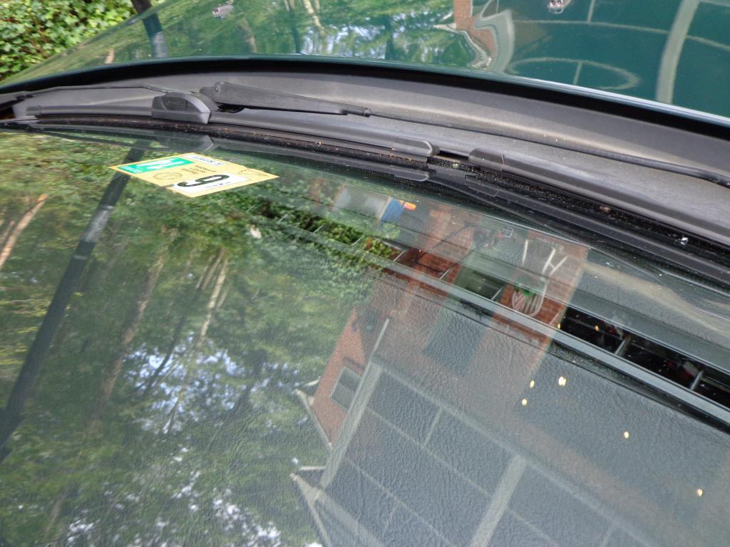

Originally Posted by jahmezis45
to the OP can you post pics of your work and how it looks now. I'm having other problems with the dash and leather around my dash speaker thinking about trying some glue type fix and want to see your work even though it was done in a different area
I don't have a before pic, but it was about a ten inch wide section that had lifted, probably three inches high. It was like a big bulge or lump when looking at it from behind. Here's a pic now from the passenger seat:
Hers a shot through the windshield. Sorry for the reflection, as shooting through glass is tough. You can see the gap fairly clear where the pad pulled back from shrinkage. Probably father time got to her, LOL.
