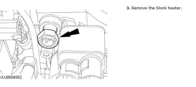

There are only 2 electrical components involved with the cooling system. 1 is the ECT temp sensor located on the top and 2 isthe Block heater located on the engine block next to the oil cooler. It would help to see the sensor you are try to install. Please post a pic. Attached is a pic of where the block heater is mounted and a pic of the heater. The block heater came installed on vehicles where there is extreme cold weather and is not found on all engines.

Attached Thumbnails Dash Temp reading extremely hot but OBD reading normal temp-block-heater.jpg
