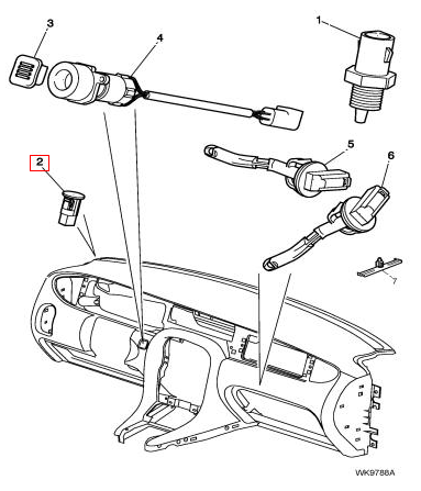

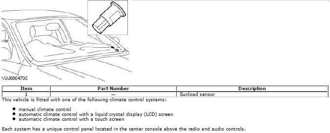

Glad to learn about this feature. Apparently the sunload sensor option was discontinued after the 2005MY.
Here's a couple JTIS references:
Attached Thumbnails Demister vent query-jaguar-x-type-sunload-sensor_1.png   Demister vent query-jaguar-x-type-sunload-sensor.png

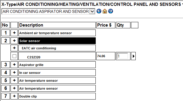

Old Oct 26, 2015 | 08:06 PM
dwclapp's Avatar
Posts: 809
Likes: 289
From: Houston, TX
And in the JEPC also.....
Attached Thumbnails Demister vent query-jaguar-x-type-sunload-sensor_2.png   Demister vent query-jaguar-x-type-sunload-sensor_3.png
