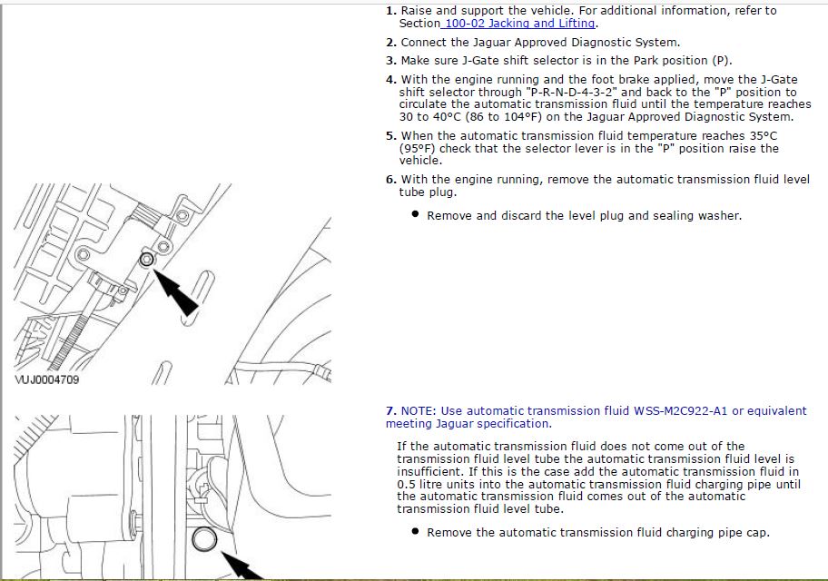

Since you don't know what the previous owner did. Have you checked the transmission fluid level? I have attached the procedure.
It has been awhile but I think I remember a seal that can go bad with the transfer case and dump the transmission.
If you have the axles and transfer case all back in place I can't think of anything you might have done wrong. If reassembled and you had noises, leaks and bad performance then I would say you might have done something wrong.
