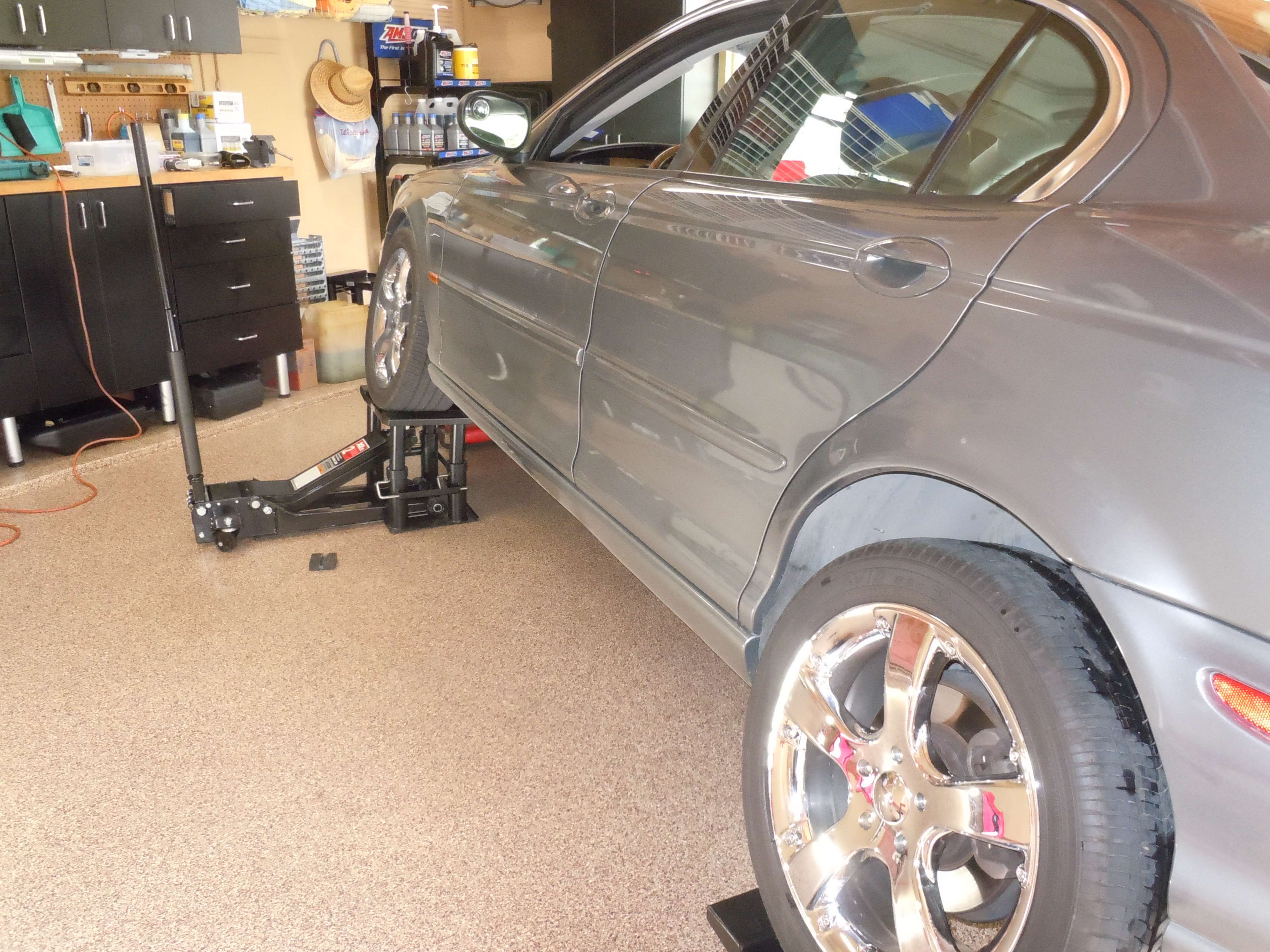

Yes, my Vacula DX2.5 hooks up to shop air. Amazon search shows currently not available, but there are other makes. Here's one that looks similar:
Amazon Amazon
You'll find the filler plug (it's the same one that's in transfer case) really frustrating, as there's not room for a standard 3/8" ratchet. You could make your own with a piece of bar stock, but the serpentine belt tool is perfect for the job, plus you'll need one anyway if you need to take off serp belt for any reason. $20 well spent at Northern Tool or Harbor Freight, less with coupon.
Ah yes, the garage floor. We bought this new home in 2009; wife said garage was mine, the rest hers. I had the floor coating professionally installed, along with bench and cabinets. Works good for me, except wish I'd had room for a lift. At nearly 68 I doubt I'll be getting the separate fully-equipped shop of our dreams.
