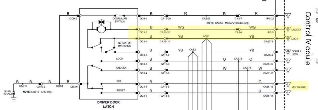

I misunderstood your problem, sorry. Too many key questions here lately. Sounds like the actuator in the driver side door isn't getting a signal. The wiring diagram shows the key barrel sends the lock/unlock signal on different pins than the control module so I would suspect a problem in the wires at the actuator connector, pins 1 and 2. The White/Green or Yellow/Black wires. Not sure this is the correct wiring diagram for your car, my electrical guide says "X-Type from VIN E19616".
