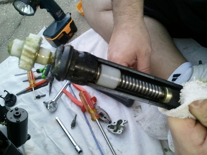

I have the same problem with the seat motors. I took the seat and motor gear system aprt. In my case the gear is missing a few tooth. The motor works but can't grab the other gear to move the seat. Paying $180.00 per motor is crazy when you know it is a $0.50 part that could easily be replaced.

This is the gear problem I was talking about.

Were you able to find a replacement gear? From the looks of all the tools laying at your feet this is not a 10 minute job or for the faint of heart.

Good sites, just as to figure out the gear/pulley specifications and how can we match them with the sites?
BTW, does the seat motor comes with the part in the pictures? If not, then changing the motor will not fix the problem.

Okay the plastic gears are stripped. There is a thread showing that you can order steel gears from a Brit car manufacturer that use the same motor but steel gears. I went to craigs list and bought a seat mechanism for about 50 bucks and swapped it with mine. Lots of wiring so take a pic before you start. Its pretty easy to do. if the motor hums, the gears (plastic) are stripped. If you hold the motor on past the end point they strip. Passengers or mechanics or valet's would possibly not give a cuss and strip them.
