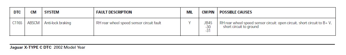

I've moved this from General Tech Help section to X-Type section. It needs the advice of the model experts.
Here is the Jaguar DTC listing for C1165:
