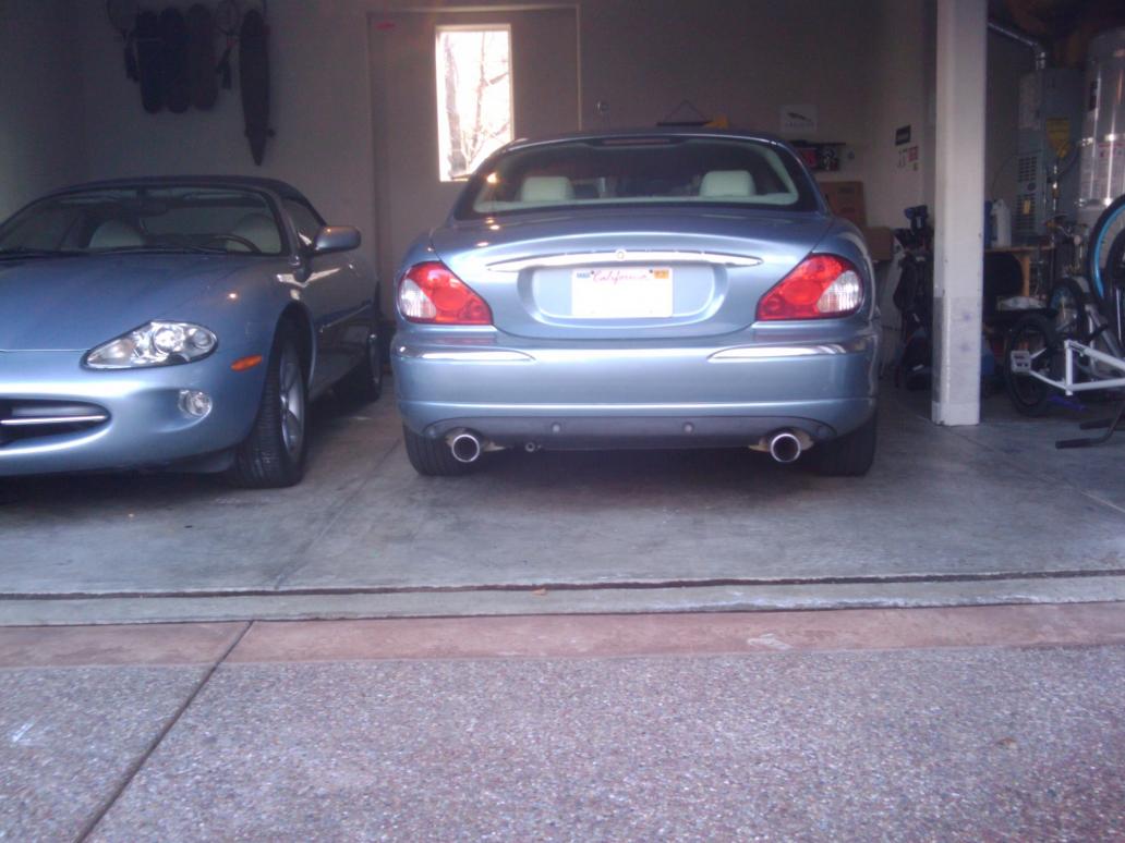

Also, Jim, is it possible to get you to take a straight back shot of your exhaust so we can see how 3.5 oval exhaust tips look straight from the back instead of your angled, artistic, shot

alright i took some quick pictures, hopefully this will help you out
Attached Thumbnails Exhaust Tips-jag.jpg   Exhaust Tips-jag2.jpg   Exhaust Tips-jag3.jpg

jag x type, any oval tip that is 3 - 3.5 inches will work as well as a round tip. I would go for a 2.5 inch inlet but a 2.25 could work aswell depending the how good the muffler shop you go to is. Those guys can pretty much weld anything together. any other questions, feel free to ask.

Thanks for the pictures jim! I'm really leaning into getting the round ones over the oval ones. The 3" round ones look real nice on our cars!!
