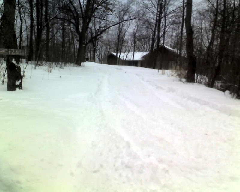

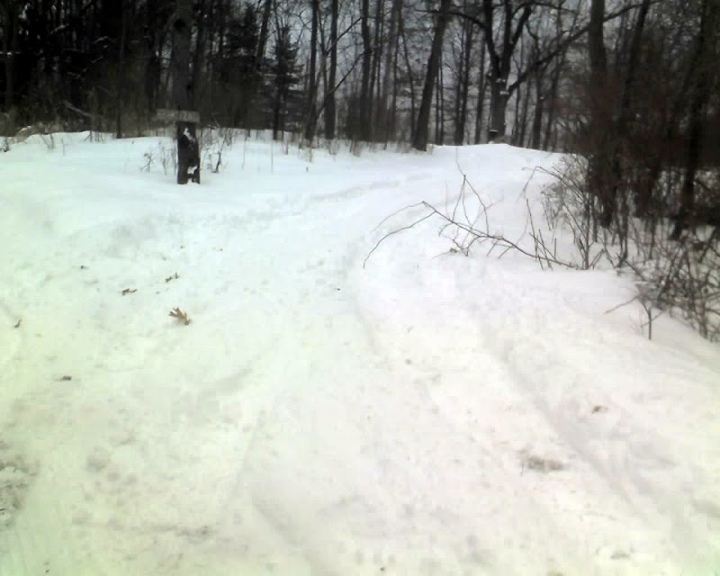

Actually though I had toyo proxes fz4's I thought they sucked but it didn't help they were bald! I got a pic of the last snow adventure I had in the jag with my cell phone camera. Can't really see the depth of it but the only car that went up the hill was my brother with his brand new tires on his explorer sport trac but he stopped near the top and went back down. I surely shocked my dad that was totally like "stop stop you won't make it, your going to get stuck and mess up your car" so naturally I went up it! Walked right up it no problems! My dad was truly shocked at the ability of the car! The car was buried in the snow!
