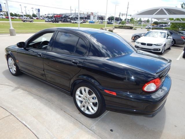

I am needing a daily and ran across a deal on a 2002 jaguar xtype with the 2.5ltr 5 spd auto. I have never owned one however the review from what i have found suggest this would be a pretty good/reliable daily it has 79k miles. I will probably look at it today or tomorrow. What should i look for and can anyone vouch for its reliability? I will take it to a shop and have them check it but would like to hear from actual owners. My daily commute is around 26-30 miles round trip to and from work for right now and is mainly highway.
Thanks in advance for any advice/input?

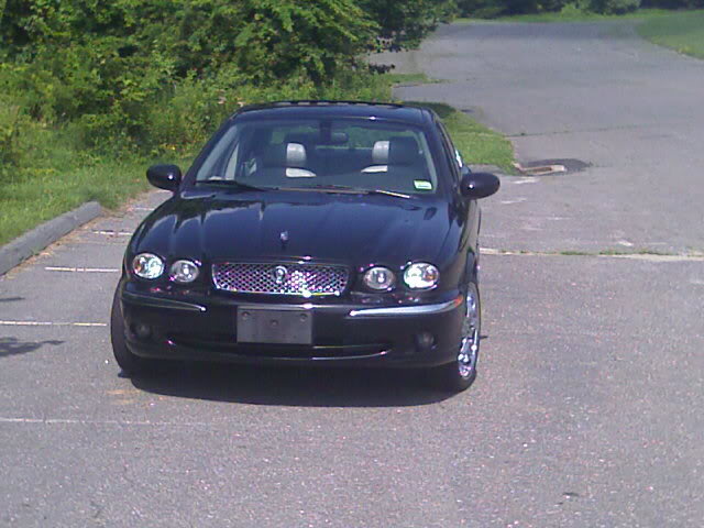

yes if you get a 2002 with manual shift you have lot less problems ,mine has no problems all i chaged was the rear calipers ,when i first got it i put redline in the transfer case and the transmision its been bullet proof ever since ,it drives and sound perfect like the day i first bought it

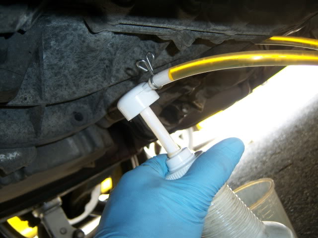

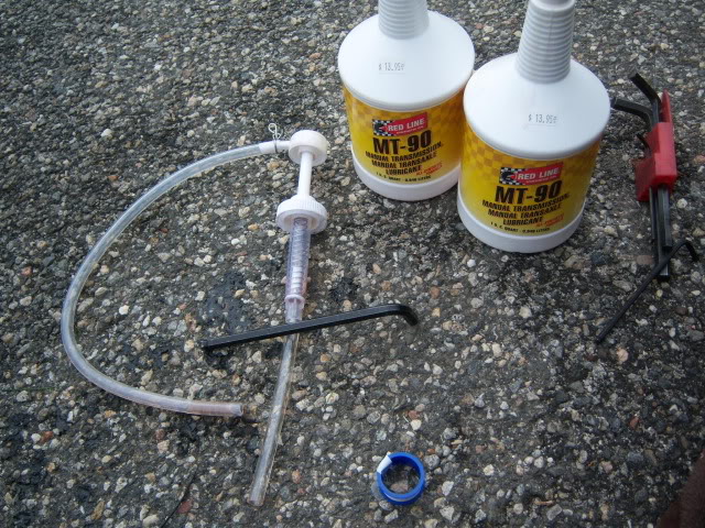

As the car gets older common issues are the 02 sensors ,they just burn out like any other car ,so buying from a dealer make sure they put it through emmisions (mot) and them register it with new plates , once you get it change the transfer oil and transmission oil
transmission oil

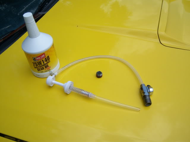

transfer case

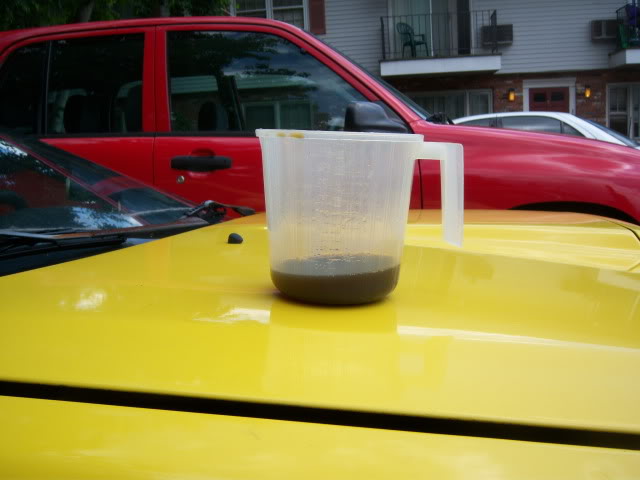

old oil
