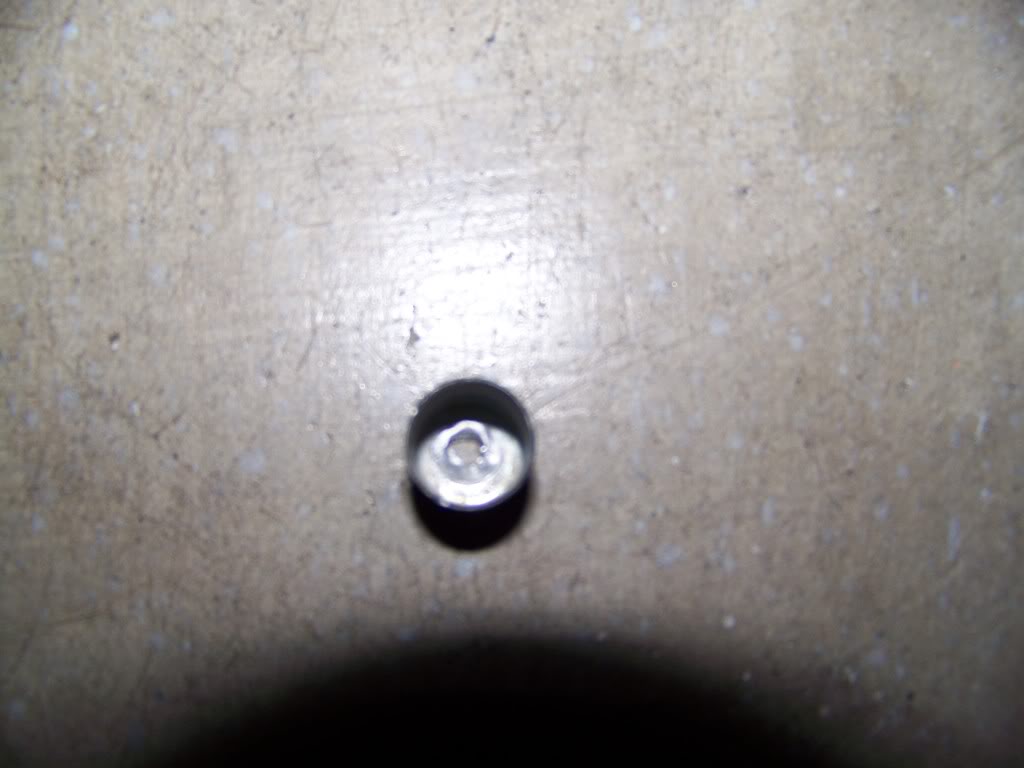

1. Secure the items.
2. The end cap was the failure point/ damaged point if yours was stolen like mine. You will notice the hole at the bottom of the cap is made bigger.
You have to options, to fashion/find a stronger replacement or repair it. I chose to repair it.
3. Place the allen key inside, and carefullt hit witht eh hammer, it should return to its orignal form.

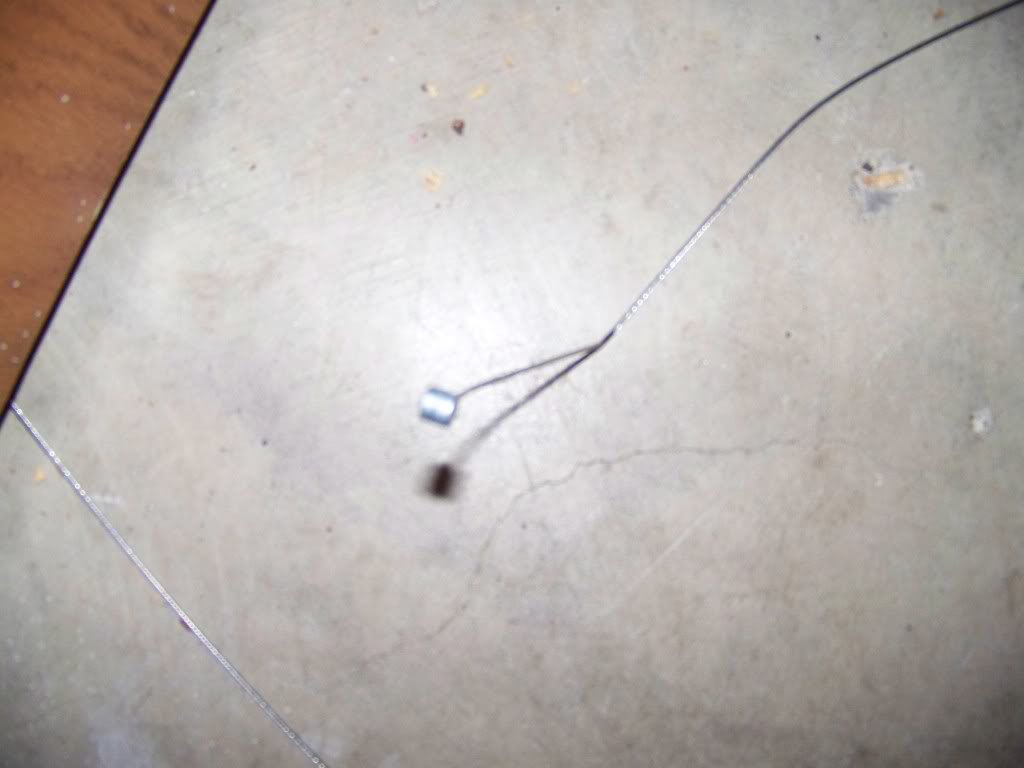

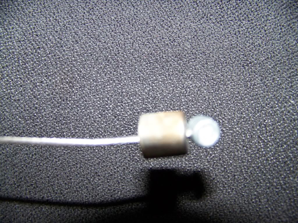

4. Thread the brake cable thorugh the hole, so the the end cyclinder is right at the hole.
5. thread through spring.
6. thread through base.
7.thread through the leaper.
thread back through the base, spring and end cap You may want to interwine as theis will be somewaht better.
8. if you are using a brake cable you will have LOTS left over.
9. compression the spring, making sure the the leaper is flush with the base, more pressure on the spring is better. Keep pullin on the excess cable till humanly hurtfull.
10, wrap tie, or weld the cable to the end cyclinder, I'm going to tie in a impossible knot.
