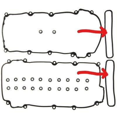

I watched some YouTube videos and it looks like the gasket for the upper is an oval and the lower is oval with a small bump out. Both are shown on the auto parts website and labeled as such, so I should be OK.

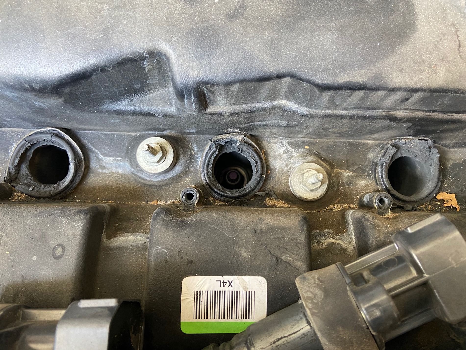

Got parts delivered yesterday and it looks like I need to replace the O rings at the coils. They are completely dried out and crumbled when I removed the first set of coils (see picture). Any reason I cannot replace them with a regular set or are/were they a special shape? Although I will probably just pick up an O ring kit, do you happen to know the size off hand?

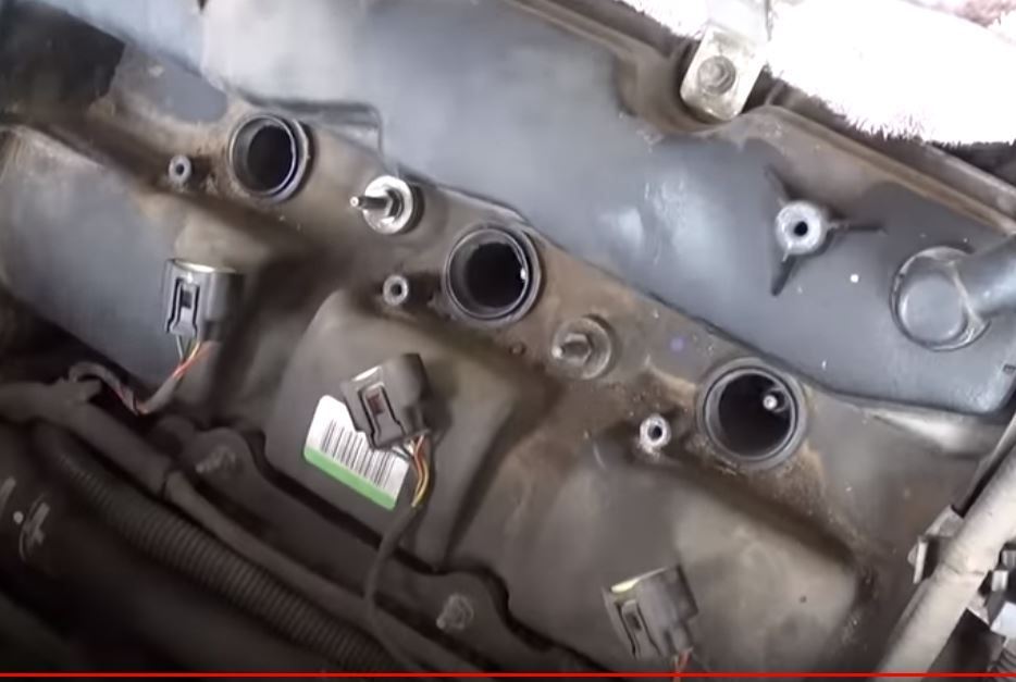

In the screen capture below from a youtube video you can see that when they pull the coils this o ring/gasket remains on the valve cover. This is what I need to replace. I have found reference to it as both a valve cover o ring and as a spark plug tube seal. And I have found it for some Jaguar models but not for the x type. The ones that I have found say it will not fit my model. I am beginning to think I may have to order it from the dealer. I am still searching but if you or anyone else on here has an idea as to where I might locate this, or a part number, please let me know. Thanks

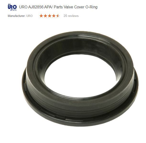

This is very confusing. Every time I do a search for this part, either stand alone or as part of a valve cover gasket kit, it shows up as a completely different seal for the x-type. You can see it in the images below. I even found reference to this in another forum post: "Replace the valve covers gaskets and spark plug boss seals. You will need a LH and RH valve cover gasket and 2 spark plug boss seals. The X-type just uses two spark plug boss seals (one per side) unlike the V8 cars that each plug gets its own seal." This part is referred to variously as valve cover o rings, spark plug tube seals and spark plug boss seals. The stand alone ones like I have all say they do not fit the x type when I go to the web page. The only ones that come up for an x-type are the ones below. Even this ebay listing says this is style is for the x type and has the actual jaguar part shown
https://www.ebay.com/itm/Genuine-Jag...-/333476166250
All of the round o ring ones say they do not fit the x type but clearly the 2005 uses them. Gonna call the dealer when they open and see what they say.
UPDATE: First Jag dealer had no answer for me and said it was not shown in the parts inventory. Referred me to another dealer who had someone there in parts who had 20 years with Jag. Got him on the phone and after research he told me that it appears to be attached to the valve cover and was not a replaceable part. He said I would either have to buy a new valve cover ($600 each) or try to find one salvage somewhere. He said even if a dealer changed plugs they would have called me and told me I needed new valve covers. I asked about using the ones for the S Type and he said he had not idea but it might not be enough clearance even if the diameter was OK. I also asked about using some sort of a liquid gasket and he said he could not recommend that as a dealer and that he really had no experience with them. Does anyone know if I might be able to use the S Type o rings?

Someone from my FaceBook Jag group has suggest this part: AJ82577 Camshaft Solenoid Seal. You can find it on Amazon. It certainly looks like it might work but I do not know the size for sure. I am trying to determine if they got this from some source that actually used this for my purposes before I order six of them.
