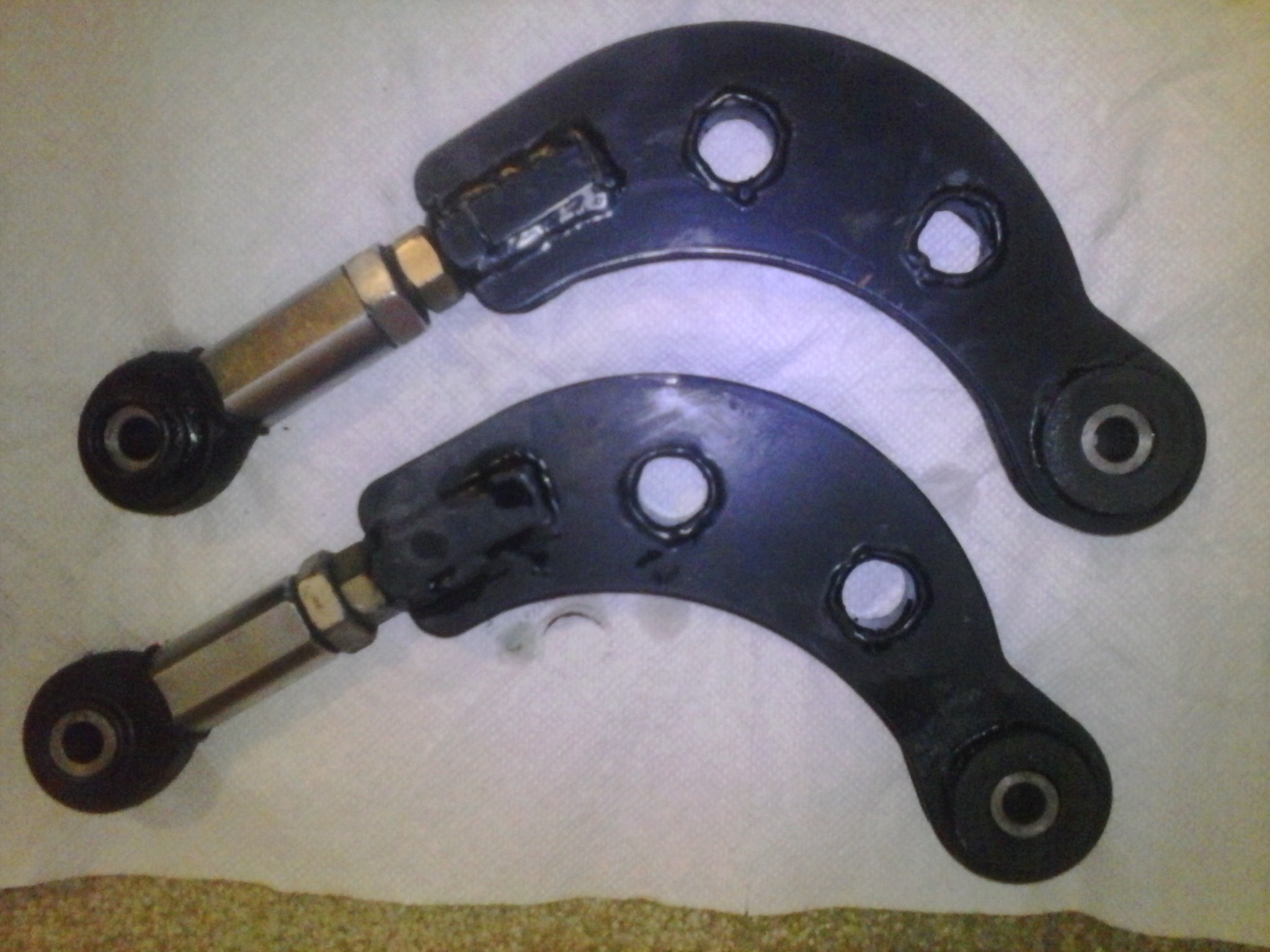

If anyone is interested I have a set of adjustable arms I'm selling. Good arms, but I finally got my other set installed that has stiffer bushings than the ones I'm selling. PM me if interested.

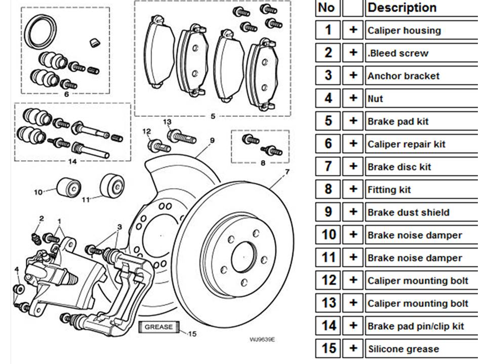

daniel3877: If you haven't yet found the source of the thumping noise when your rear tires go over bumps, consider this possibility....
Confirm that the brake noise dampener wheels are tightly secured on both rear brakes. It's the small rubber wheel labeled #10 and #11 in the attached picture. These are designed to supress vibrations / brake noise. But if they become loose - as one did on my car - they make a thumping sound each time you hit a bump with that rear tire. It took me a while to discover that it was loose because they are concealed on the inside, top of each rear brake. The easiest way to check on them is to back your rear tires onto ramps and slide yourself under the trunk where you can reach up and ensure they are tightly secured to the rear calibers. If one is loose, a small socket wrench is all you need to tighten it down, assuming it hasn't been loose long enough to damage the threads on the securing bolt (as mind did).

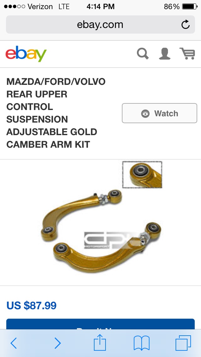

Is this the part you guys are talking about? Just want to double check
Attached Thumbnails Found: Adjustable rear upper control arm-image.jpg
Old Oct 13, 2014 | 03:38 PM
  #89
dwclapp's Avatar
Posts: 809
Likes: 289
From: Houston, TX
Yes, that's the part, but it's $88 for one. Here's a $93 listing for two (Left and Right use the same part):
Black Rear Upper Control Arm Camber Kit 04 07 Mazda 3 5 S40 V50 00 12 Ford Focus | eBay
