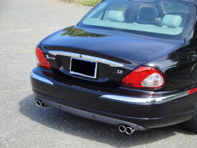

same here

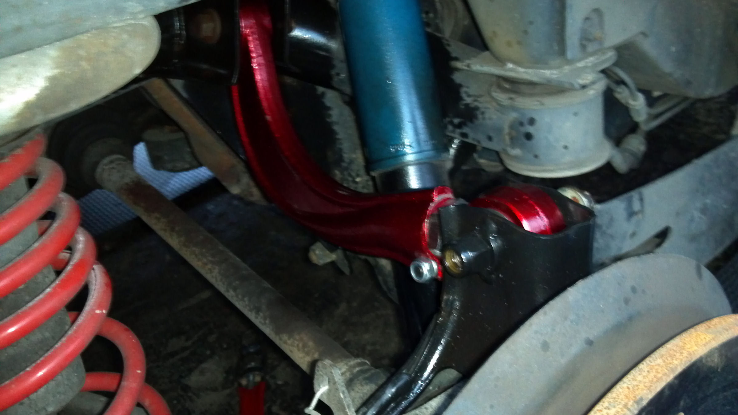

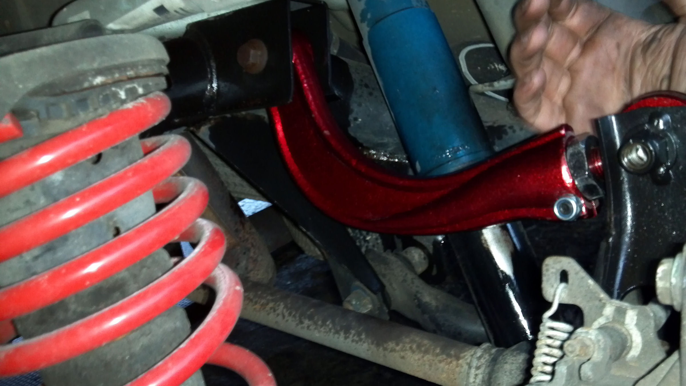

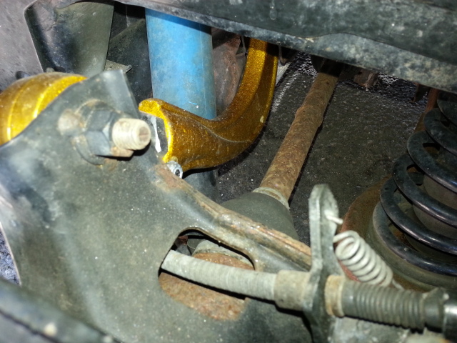

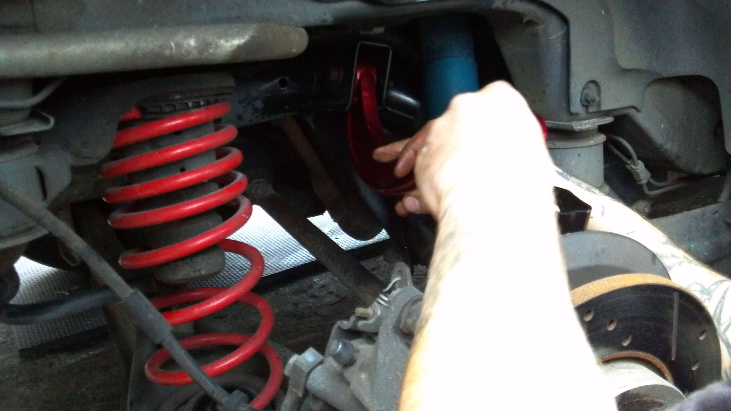

i also did the lower lateral arm also now its dead straight thanks thermo
sorry for all the pics
Attached Thumbnails Found: Adjustable rear upper control arm-20130527_121707_zpsebaa295c.jpg   Found: Adjustable rear upper control arm-20130527_121716_zps60d8477c.jpg   Found: Adjustable rear upper control arm-20130527_121739_zpsc5ae12a3.jpg   Found: Adjustable rear upper control arm-20130527_121745_zpsf3e27814.jpg   Found: Adjustable rear upper control arm-20130527_122606_zpsf783b69a.jpg
